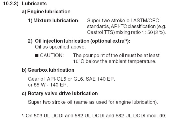

PostPosted: Mon Apr 23, 2007 9:31 am    Post subject: More on Rotax 582 oil Reply with quote
Deke,
I think what is confusing on Pennzoil is they call it Outdoor brand now but
there is definatly a difference between the Air-cooled and outboard oils.
It shows in the ratings on their site as I posted earlier.
Air-cooled - API- TC - This is what Rotax calls for .
Outboard - TC W3 - This it NOT what Rotax recomends
http://www.rotax-aircraft-engines.com/pdf/dokus/d04085.pdf
go to section 10.2.3
It calls for API-TC -sorry cannot copy and paste it .
Dave

PostPosted: Mon Apr 23, 2007 4:48 pm    Post subject: More on Rotax 582 oil Reply with quote
I'll give it a try:
[img]cid:361554700(at)24042007-2EFA[/img]
Noel
