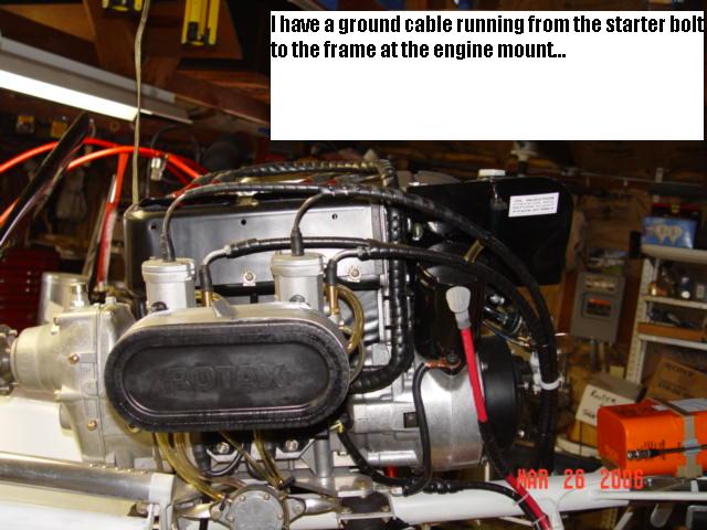

Posted: Wed May 02, 2007 5:26 pm Post subject: Re: Firestar II - installation of electric start |
I have the GPL starter....Works great...I like it....But it adds about
30 -35 lbs to yer plane ...Starter / housing/wiring/Battery/ignition switch
In the attached picture....you can see the starter & Housing
Gotta Fly...
Mike & "Jaz" in MN
