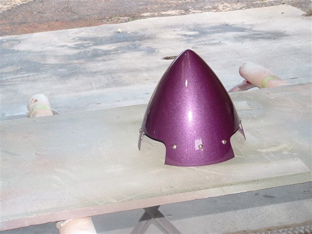

I got a UHS for my IVO through Aircraft Spruce...pre cut also...

Low & Slow
Rick
