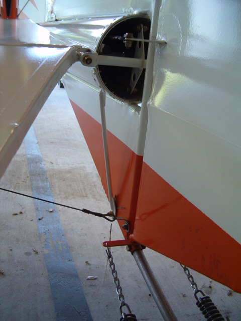

| Description: |
| Tail post brace - if you look close, acks like a thousand mini tailhooks in tall grass. Helps on short field. |

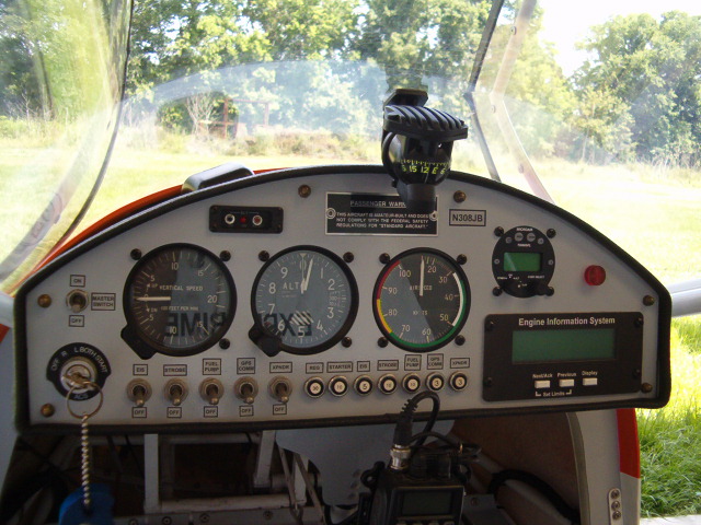

| Description: |
| Made new instrument panel. Labels are idea off another site. Avery Labels and laser printer. |

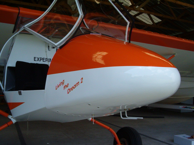

| Description: |
| Repaired nose cone. Looks a lot better than all the cracks and dents she had in her. |
