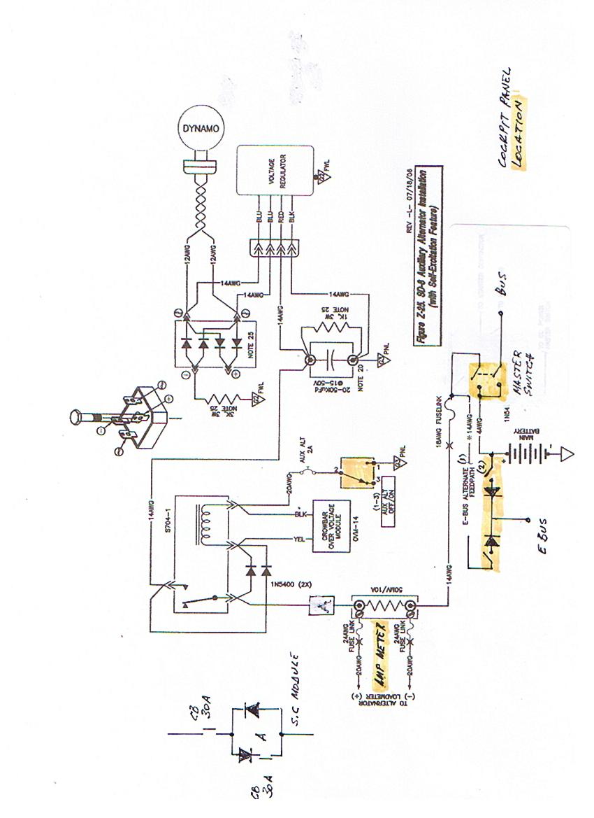

Bob,
I have been guilty of asking a lot of questions before reading your files and thanks to Gilles, Ken and yourself for the advice and patience.
Your files are a gold mine of good engineering design.
My project is for conversion of a Quickie Q-200 with Jab 3300 single phase PM alternator and a regulator like the SD-8 setup to make a safe dual independent power supply ready for an EFI conversion.
The original Quickie circuit has no relays and protection is by fuses to each connection and the DPST master switch which isolates battery from alternator from bus.
Z-25 covers everything I think I need except for the dual independent source for the ebus.
For this I have copied a practice I have seen here in Oz which I understand is approved by CASA as a dual independent power supply by taking the centre tap from two diodes back to back and I have shown the setup at the bottom of Z-25 following. I have also included an over current module “A” which I had from another installation. (Gilles has pointed out that either the fusible link or the OCM is redundant).
The ebus feed that I have shown here is I think similar to what you have done in Z-19 note 24.
I want to keep the thing as simple as possible and have left the SPDT master switch but would use a relay if you advise.
I would welcome your advice on the merits of fusible links vs CB which reset or can be reset, and whether you think the OCM is worth keeping, or if you see something wrong with the diagram.
Peter.

PostPosted: Thu May 03, 2007 4:19 am    Post subject: BASIC DUAL INDEPENDENT POWER SUPPLY Reply with quote
Peter
Much as I hate attachments (slow dial up connection), I took a quick
look and I really think you are kidding yourself about this.
Look at all the things that can fail your alternator and it's wiring. I
suspect that a modern sealed battery is an order of magnitude more
reliable for its first couple of years of life. Even in the unlikely
event that the battery did fail, it is unlikely to do so in a manner
that will bring down your system. I suspect that your proposal adds no
reliability to your electrical supply. A separate small battery would be
there if it were my system and I was concerned about supply reliability.
Yes I'd keep a fuselink, C/B, or fuse near the battery so that a short
in the alternator or all that wiring doesn't draw a lot of current out
of the battery.
Now for the sake of discussion... If you really want to do this - what
about considering a separate alternator feed right from the alternator
that would include a second rectifier/regulator operating with or
without a separate battery Wink Separate wiring and no excess connections
such as loadmeters.

Peter Harris wrote:
Bob,
Peter.

Hmmm . . . when folks "who know more about building airplanes than we do"
get into the loop . . . well. Let's not go there.
How do you plan to use this airplane. Are you intending to
file for flight into IMC? Are you planning a vacuum system or
all electric? What plans do you have for electronic and/or attitude
displays?
Do you plan a wing leveler? GPS or magnetically aided . . . or both?
Do you plan to fly at night? What equipment items did you plan to
power from the e-bus?

The aircraft will be used only for VFR day. It is equipped with a compass
and a GPS for nav and the usual engine instruments all of which are fused
off the main bus. For ignition it has a single electronic ignition module
and a single magneto. I also have a Ray Allen T2-7A servo for aileron reflex
which is non essential.
No wing leveler or other electricals. No pneumatics .
For monitoring the electrical system I have a dual voltmeter/ampmeter also
an alternator no charge warning light. I have ordered the OVM crowbar module
and have the parts to do the self excitation as in Z-25. The jab regulator
looks like it is in the same family as the PMR 1-14.
From the ebus I plan to supply an EFI system including an ECU, Fuel pump and
two injectors as well as the EI module. Total load is expected to be less
than 8A. I would use LED s to indicate each of the dual sources active and
would operate with both sources normally active.
Thanks Bob
Peter

Hmmm . . . that's a lot of snort to keep the engine
running. Okay, over the terrain you expect to fly, what's
the general availability of alternate landing sites? How
much ENDURANCE do you expect to plan for? Servicing an
8A engine requirement for 3+ hours doesn't seem like a
really useful philosophy. It would make you carry around
a LOT of lead having a low-probability of ever being
needed. Also, I'm skeptical of the 8A figure. Do you
know anyone flying this engine from whom you might get
some real, operating measurements?

Bob,
The EFI including pump, ECU and injectors together with his main bus radio
and instruments is using 4A according to advice from the guy who engineered
this simple single body TBI system. (I don't have a figure for the separate
ebus draw for the EFI so you would need to discount for radio and
instruments)I could also run the electronic ignition module and ignition
coil for additional ebus current I guessed 4A but it would probably be less.
I am using a Bosch HE coil.
Alternative landing sites are up to 1hr apart. The endurance is 41/2HRS.
Peter

Just to clarify I do not propose to use Z-19 , only the two diodes dual feed
as shown in Z-19 and note 24. What I have in mind is to use Z-25 just as I
have shown it in my post ie Z-25 plus the double diode feed from Z-19
Peter

Ken,
The idea of a second regulator feed I like better than a second battery, a
very good idea I think. The PM alternator itself is likely to be very
reliable long term.
What protection would you use for the second feed? Is this a case for a
transorb and a CB which can be reset on the panel?
I am already using the diodes as shown switched NC with a green LED to show
each side active. Now Z-25 solves the problem of running the alternator
without the battery.
Peter

PostPosted: Sun May 06, 2007 9:03 pm    Post subject: BASIC DUAL INDEPENDENT POWER SUPPLY Reply with quote
At 07:13 AM 5/5/2007 +1000, you wrote:
<peterjfharris(at)bigpond.com>
Bob,
Peter
So how much batter-only endurance are you designing for? What
plans are you making for preventative maintenance to make
sure that design goals slip for lack of due diligence in
maintenance?
Assuming you're considering a battery capacity on the order
of the popular 3 x 6 x 7 inch form-factor, a 4A load on a
new battery will give you just over two hours of operation
assuming that nothing in your system gives up above 10.5
volts. See:
http://www.aeroelectric.com/Pictures/Curves/17AH_Capcity_vs_Load.gif
Here we see that a 17 ah battery will carry 4A for about 3 hours.
http://www.aeroelectric.com/Pictures/Curves/28AH_12V_Capacity_vs_Load.gif
To go out for duration of fuel aboard, you'll need to upsize to
the 28 ah critter for an increase to something on the order of
360 minutes or 6 hours.
It's my recommendation that you consider z21 posted at:
http://www.aeroelectric.com/PPS/Adobe_Architecture_Pdfs/Z21A.pdf
Stuff needed to keep the engine running should run from
the battery bus and be switched by their own power switches
SEPARATE from DC power management for the rest of the airplane.
You don't need the diodes. A battery does not fail in a manner
that takes the rest of the system down. Tying the alternator
directly to the battery al-la Z13/8 lets you load-shed the
main bus plus contactor and run only battery bus + ebus loads.
Even the e-bus can be shed if desired.
I presume you're planning on carrying flight-bag backups
for the panel mounted hardware like
http://www.aeroelectric.com/Pictures/Misc/Failure_Tolerance.pdf
This architecture meets the design goals of dual supplies
for keeping the engine lit up.
nuckollsr(at)cox.net
PostPosted: Sun May 06, 2007 9:06 pm    Post subject: BASIC DUAL INDEPENDENT POWER SUPPLY Reply with quote
Bob,
Peter
Never thought you were proposing Z-19. That effort was produced
for other builders. You don't need the diodes. See my earlier
post on this topic and the new figure Z-21

PostPosted: Sun May 06, 2007 10:20 pm    Post subject: BASIC DUAL INDEPENDENT POWER SUPPLY Reply with quote
Bob, thanks I see now that battery capacity design and maintenance will do
the job the simplest way.
Yes I do have a Magellan 315 and it is loaded with bush air strips as well
as regular airports.
I am not sure if I understand what the self excitation feature is
contributing, do we need it here?
Peter

klehman(at)albedo.net
PostPosted: Tue May 08, 2007 5:12 am    Post subject: BASIC DUAL INDEPENDENT POWER SUPPLY Reply with quote
With my belt drive dynamo I feel that the regulator is not really a weak
point in the system compared to the belt, bearings, wiring, etc.
However with a Jabiru that has I think a direct drive dynamo, would
there be any value in having a second regulator that could be manually
connected to the battery or the e-bus?
Regulator failures do seem to happen much more often than dynamo
failures. Personally I'd be content with Z-21 as it is probably more
reliable than his EFI system, but Peter seems reluctant to just rely on
battery power for extended endurance after an alternator failure. A
second regulator is light and wouldn't necesarilly need OV protection if
switched in manually. However it would only cater to a regulator problem
and wouldn't help if the dynamo quit...
I should find note 25 for Z-21 as well. I semi followed the discussion
on self excitation a few months ago but it is not obvious to me how the
two resistors and diode achieve self excitation when I look at Z-21 now.
Ken

PostPosted: Tue May 08, 2007 6:21 am    Post subject: BASIC DUAL INDEPENDENT POWER SUPPLY Reply with quote
Certainly things that move, flex, need lubrication, and vibrate
are victims of certain kinds of stresses and have obvious
limitations to service life.
Things that don't move and need grease are not immune from
their own stresses which can have an effect on service life
too. Just because it's "solid state" doesn't mean that it's
automatically more likely to outlive any other component
of the system.
However with a Jabiru that has I think a direct drive dynamo, would there
be any value in having a second regulator that could be manually connected
The key term here is "value". Indeed, a calculation of
cost-of-ownership along with a probability study for
any particular failure offers the math and statistics
junkie an opportunity for a couple-hundred hour high.
Adding another regulator increased parts count not only
by doubling the number of regulators but adds a switch
to select between them which has its own unique failure
modes.
Regulator failures do seem to happen much more often than dynamo failures.
. . . an anecdotal observation that may be true but to
simply add-another-regulator may not be the optimal
solution. WHY does the regulator fail? If it had a better
heat sink, would it last longer? If it were redesigned
slightly, would it last longer? Until one knows root cause
of a failure, the only "remedy" is to play swap-tronics . . .
add-a-spare, change brands, etc. It may be comforting
from the neophyte's perspective but in fact could have
no useful effect on probability of avoiding a sweaty
experience while airborne.
Personally I'd be content with Z-21 as it is probably more reliable than
his EFI system, but Peter seems reluctant to just rely on battery power
I don't read that into his words. His question was
to identify a methodology for crafting "dual, independent
power supply". His original notion was that diodes were
necessary to acquire independence . . . which is not
the case. Moving the alternator feed from bus to battery
side of the contactor covers the issues for a failed
battery contactor.
A second regulator is light and wouldn't necesarilly need OV protection
if switched in manually. However it would only cater to a regulator
problem and wouldn't help if the dynamo quit...
The dynamo is wire wound around a stack of laminations
with no moving parts. If these things quit, then it's
because a wire broke. That's an exceedingly rare event
unworthy of worry.
I should find note 25 for Z-21 as well. I semi followed the discussion on
self excitation a few months ago but it is not obvious to me how the two
It' provides a high source impedance "leakage" around
SCR's internal to the regulator such that the rectifier/
regulator is never completely shut down. This causes
output from a dynamo to keep a low voltage charge on the
output filter capacitor sufficiently elevated to keep
the regulator's control circuits from shutting down.
Note 25 is a general note for Appendix Z found on page
Z-11 of
http://aeroelectric.com/articles/Rev11/AppZ_R11J.pdf
The foundation for this exchange rests solidly on
the notion that a WELL MAINTAINED battery is the most
reliable source of energy aboard the aircraft. Of course
one strives to reduce likelihood of charging system
failure . . . but this is ALWAYS best achieved by
increasing service life of the existing components
as opposed to increasing numbers of components.

PostPosted: Tue May 08, 2007 11:04 am    Post subject: BASIC DUAL INDEPENDENT POWER SUPPLY Reply with quote
Sometimes redundancy means two pieces of hardware dying at the same
time. I installed two hard drives in a RAID configuration on my
computer for the sake of redundancy. I found a good deal on 7200RPM IBM
drives, so I bought a couple. Ran great for years. Fast and reliable.
Then both drives crapped out (technical term) within hours of one
another. I lost nearly everything. I noticed the problems with one
drive, and the other died before I could finish a backup. The serial
numbers were within about 4 units of one another. They lived in the
same environment, and fed off the same power supply.

PostPosted: Tue May 08, 2007 6:11 pm    Post subject: BASIC DUAL INDEPENDENT POWER SUPPLY Reply with quote
Bob the true practical value of Z-21 is still sinking in and I have been
researching batteries. The experienced advice that I am getting down here is
not for Odyssey incidentally because of variable quality and that ties in
with a recent post. Sometimes I think that we get suspect product down here
because we are a long way from the big market. I have been shown an
HGL35-12. I was definitely interested in Ken's original suggestion to
consider dual regulators because I had never seen the idea before. I had a
regulator failure years ago and with the unprotected Quickie circuit and a
Revmaster PM installation with no warning on a 900 NM trip. The battery was
almost boiling when I arrived after the second leg of the trip. Scary. No
concern for that issue with any of your circuits but it is still in my mind
that the regulator is the weakest link in the power supply and may be a
candidate for a properly designed duplication?
The "no sweat" electrical system is one that can tolerate any
single failure. You experienced what appears to be a runaway
that ran unabated. This produced a second failure which, if
allowed to run longer, might have smoked lots of stuff.
One can stack redundancy on top of redundancy but in every
case you first need to do drill:
How can this part fail?
Is it preflight detectable? If so, is it on my
preflight check list to look?
How will I know that it failed while in flight?
If failure occurs in flight, is it useful for
comfortable termination of flight?
If so, what's the plan-b for replacing its
usefulness?
Finally, the most effective failure mitigation
plans include a preventative maintenance program
that tracks time in service and/or present
degradation of performance so that a replacement
is made long before failure.
A "Plan-B" for a failed part is best crafted from
completely different parts and architecture. For
example, hand-helds in the flight bag are totally
independent of panel mounted hardware and (assuming
batteries have been maintained) can be counted
on to function when needed.
So, if you've done the homework and preventative
maintenance that insures sweat-free termination
of flight in spite of a failed regulator then
adding a second, switched regulator is not the
minimum parts count nor totally independent scenario
for plan-b.
For example, the Cessna Skymaster and Beech Barons
had single regulators driving both alternators in
parallel. Someone thought that "twin engine reliability"
could be maintained by providing a second regulator that
could be switched in to replace a failed main regulator.
But suppose a short on the field circuit takes out
one regulator. Switching in the standby regulator
produces TWO failed regulators.
If it were my airplane, Z-21 would be the way to
go. If the engine were fitted with dual ECFI systems
like the Subaru conversions featured in Z-19, then
a second battery provides total separation of power
sources for dual engine electronics. Given that your
engine is fitted with a single system, then there
ARE single points of failure that are not going to
go away no matter how many power sources you carry.
Hence, I'd be more interested in believing that the
ECFI had the reliability of propeller bolts than with
stacking on more power sources.
