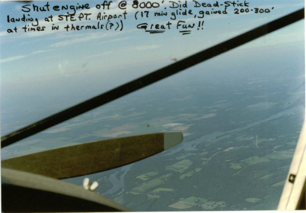

Here's a picture with notes from way back in about 1987 when I was flying
the prototype Avid/kitfox and practicing dead stick (which Dean Wilson had
suggested due to the unreliable nature of the Cuyuna two stroke engine).
All in all I logged 3.8 hours of dead stick time in that airplane, mostly
because it was so much fun to do. And some of that time included when it
was on floats. Fwiw - I always landed dead stick. Not once did I do an
airstart. Landing was the most important part to know in my opinion, and
also the most fun. Plus, the 1st time I tried to airstart (of course it was
on the 1st flight I shut it down), the engine wouldn't start by tugging on
the recoil, and I couldn't get enough airspeed to get the prop to turn fast
enough to help my now tired arm. Why wouldn't it start? Well, I never
thought about how cold an engine can get in a very short time of gliding
around at 60 mph up in very cold air. I later learned I needed to choke it,
but being low enough after wasting a bunch of time tugging on that recoil, I
decided it was better to fly the airplane making certain I was totally
prepared to make a good landing at the airport than it was to waste any more
time (altitude!) trying to get it going. So lesson number one I would say
when you shut off an engine in flight....be mentally prepared to land, and
have a landing site directly below you. There is no guarantee your engine
will restart!
