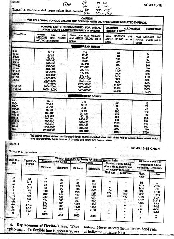

PostPosted: Fri Jun 15, 2007 8:50 pm    Post subject: brake / fuel line fittings nut torque Reply with quote
Hope this sizes correctly. AN torque values at the bottom of attachment and
also on page 9-19 of AC 43.
ON page 7-8 and 7-9 of AC 43 (Acceptable Methods and Techniques) it gives
the conversion formulas. Very easy to set up in a spreadsheet.
Shows Crows foot wrench as a "Short Open End Adapter" on pat 7-8
Crows foot wrenches from Sears and adjust for about 1 & 1/2 inch offset.
Actually should have the conversion formulas in the instructions with your
Torque Wrench.
Hope this helps

MauleDriver(at)nc.rr.com
PostPosted: Sat Jun 16, 2007 4:23 am    Post subject: brake / fuel line fittings nut torque Reply with quote
That really helps. Thanks for taking the time to scan.

Bill Schlatterer
Posts: 195
PostPosted: Sat Jun 16, 2007 7:51 pm    Post subject: brake / fuel line fittings nut torque Reply with quote
I just noticed on the scan that I had highlighted the fine and coarse thread
torque tables and the highlight covered up the fine and coarse headings.
Fine thread torque values at the top, coarse in the middle, there is a big
difference. The AN tubing torque values are on the bottom.
Glad it helped but the best thing to do is get a copy of the AC 43. It's
cheap from Avery or Spruce.
Bill S

PostPosted: Sat Jun 16, 2007 9:12 pm    Post subject: brake / fuel line fittings nut torque Reply with quote
The needed pages are Pages 7-6 through 7-12 and 9-19 specifically for
torques on brake and fuel tubing. I have PDFed the needed pages but for
the benefit of the string and tin-can group it is 4.9MB. So, Send me a
request (offline) and I will forward the passage to those with
high-speed bandwidth and open attachment capability.
If you have a spring adjustable torque wrench don't forget to release
the pressure after using the tool... it helps calibration.
