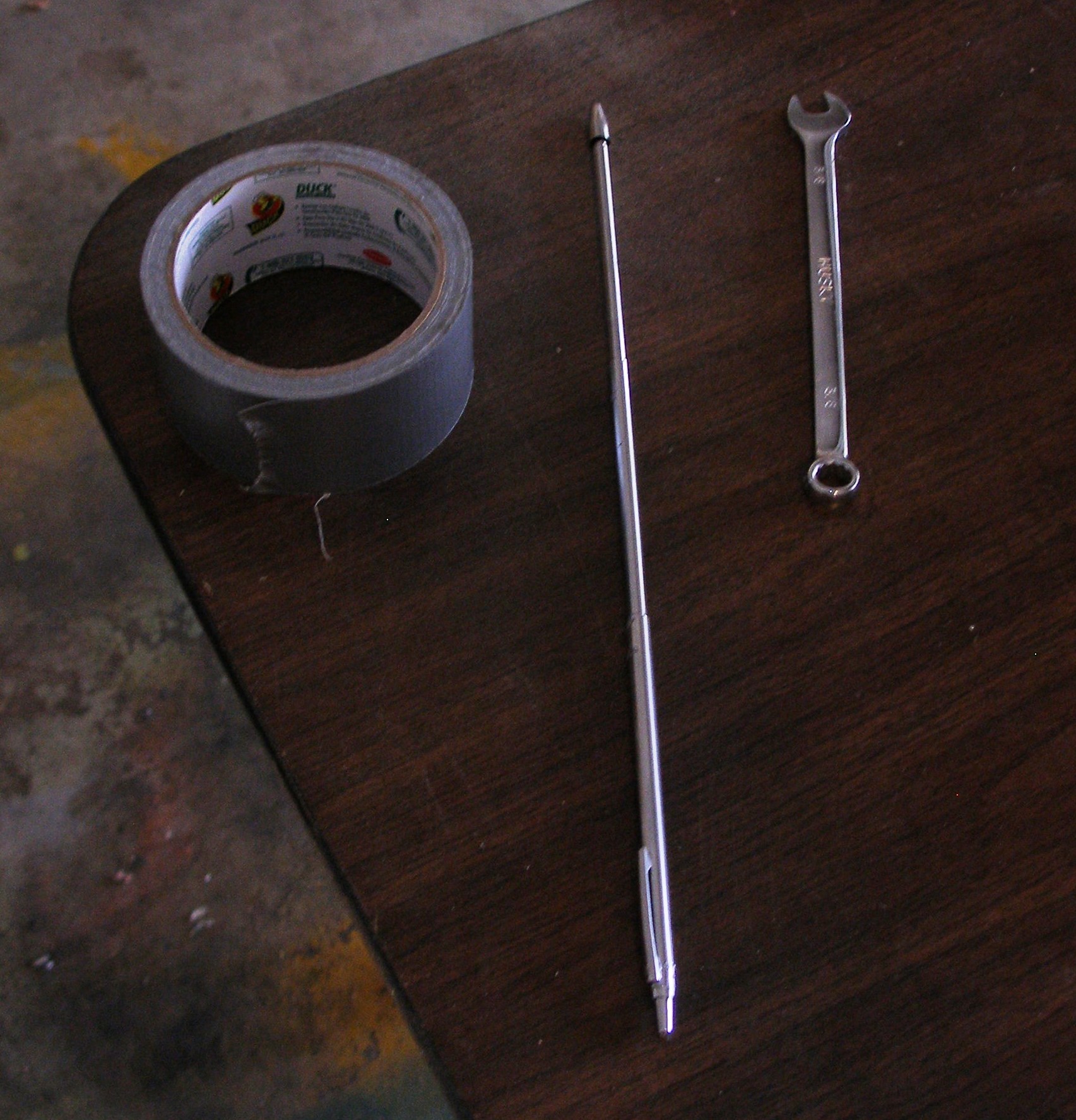

I did that job with the center spar section out of the airplane and on a work table. That probably isn't an option with the quick build kit. Anyway, I used one of those old shirt-pocket, telescoping pointers. To that I duct-taped an open-end box wrench. To the open end wrench, I put a small piece of duct tape on the flat which would be at the back when inserted into the spar slot. That little piece of duct tape holds the nut. The bolt is inserted and rotated from the outside. It sounds a lot easier than it really is! Patience, a steady hand and more patience are an absolute necessity. A good, full set of verbal obscenities might be helpful. Good Luck !!!

 Filesize:  524.45 KB
 Viewed:  662 Time(s)
