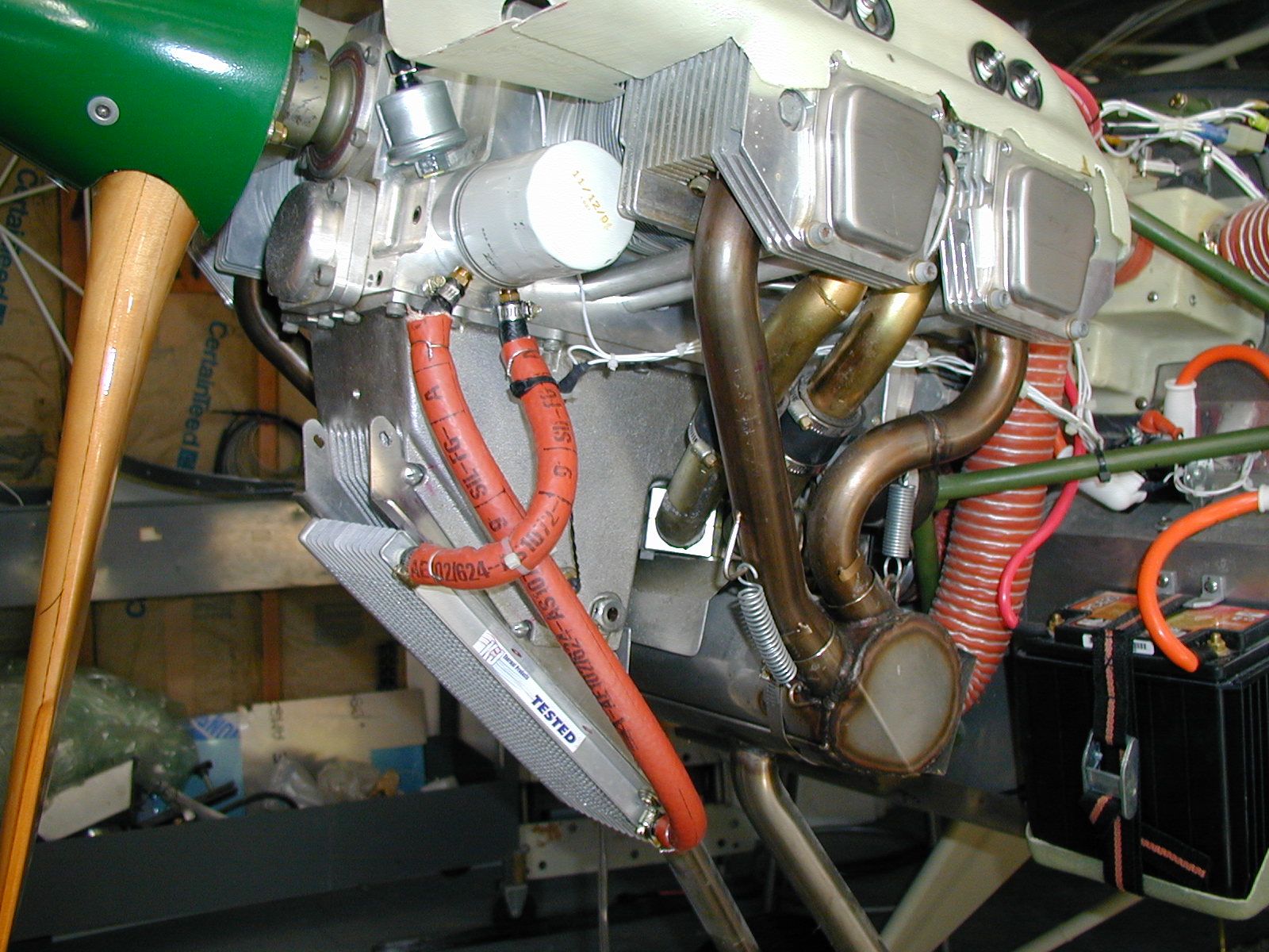

Thanks for the information, My Jabiru 2200 is new, but a few years old. I've not started the engine yet, just cranked it with the starter to
check things out. I plan to actualy start the engine in two week. The engine has a relief valve as well as a oil cooler. I'm using Shell
mineral for the engine break in period. Seems from you guys are saying is the cold oil pressure is ok. I'll find out for sure when I actualy
start the engine. I don't want to fry my nice new engine.
