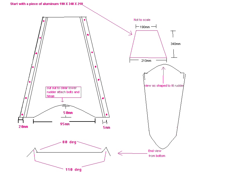

This msg did not get posted due to the zip attachment. I converted the file to JPEG to reduce its size.

I read your note too quickly: I was thinking of the fairing on top of the stabilizer, in front of the rudder - see attachment (it's a 1.4 MB bitmap, but only 9K when zipped).
BUT - I did remembered that Peter Chapman posted his solution years ago (fairing under horiz stab) .
Fortunately, his web site is till around:
http://web.ionsys.com/~pchapman/zdc/zdc_photos_construction.htm
Cheers
Carlos
