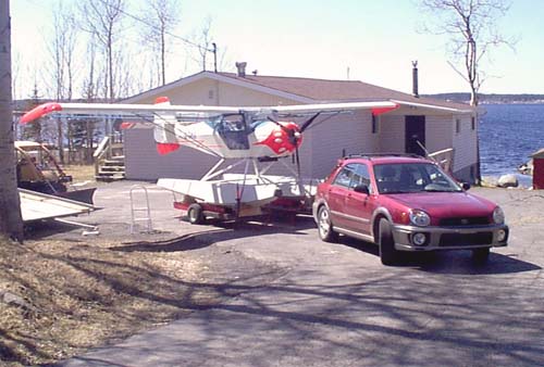

Pull the plane in to the beach tail first... Then inspect the tail and wings from the beach. The rest of the plane can be inspected from the floats. Most of the time though I fly with my waders on and rolled down below my knees.
The other thing is my plane is stored in the garage here at the house, about a mile or two, from the pond I launch from. So I have lots of time to pre flight.
[img]cid:728424902(at)04072007-1AEC[/img]
Of course I have to tow with the wings folded. The water in the background is part of the North Atlantic. Picture taken May 2006.
