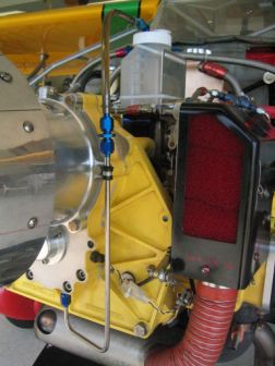

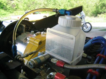

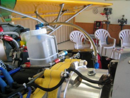

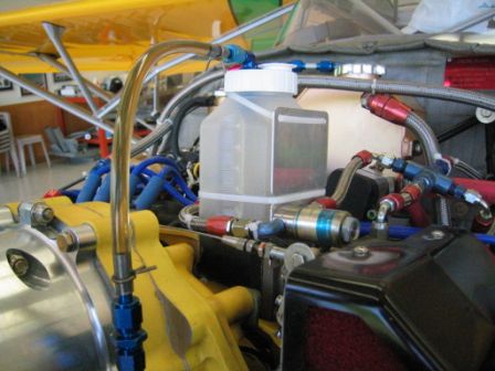

Hi Kurt,
I hope these pixs help
Peter Graichen
http:/home.neo.rr.com/n10pg/kitfox.htm

PostPosted: Sun Jul 22, 2007 6:36 am    Post subject: NSI transmission breather Reply with quote
Thanks Peter,
Looks like a simple setup. It looks like oil goes all the way to the reservoir. Is that correct?

n10pg(at)neo.rr.com
PostPosted: Sun Jul 22, 2007 11:06 am    Post subject: NSI transmission breather Reply with quote
Hi Rick:
As you can see from the pixs I posted, I made a connection from the gearbox bottom drain to a plastic overflow bottle. The tube goes all the way to the bottom of the overflow bottle. The overflow bottle is vented. As the gearbox heats up during operation the internal pressure increases considerably without this vent. This does lead very easily to oil leaks around the seals.
During operation the pressure buildup expells about 5 fluid ounces of oil into the overflow bottle. As the gearbox cools after shut down, it sucks all the oil back into the gearbox. It is basically the same setup as the coolant overflow. As far as oil mist within the gearbox is concerned, I can not see where my setup would make any difference.
Peter Graichen

GENTRYLL(at)aol.com
PostPosted: Sun Jul 22, 2007 2:27 pm    Post subject: NSI transmission breather Reply with quote
Peter,
Since some oil obviously drains out of the gear box and into the tube, do you just try to add enough oil to start with to make the oil level in the gear box and the tube about the same height as the top of the gear box, or do you allow some space there also?
Float Flyr
Joined: 19 Jul 2006
Posts: 2704
PostPosted: Sun Jul 22, 2007 5:46 pm    Post subject: NSI transmission breather Reply with quote
Why is your breather out of the bottom of your redrive instead of the top?

n10pg(at)neo.rr.com
PostPosted: Sun Jul 29, 2007 7:44 pm    Post subject: NSI transmission breather Reply with quote
I fill the gearbox with the specified quantity. In my case that is 850 ccm.
Peter Graichen
