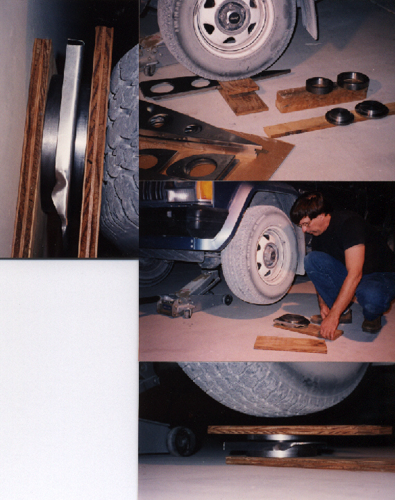

I'm crushed, CRUSHED that Doug considers my "gravity powered lightning hole
press" method as "noise" on the list. The bigger point is that nearly every
builder has these tools (a truck and a hydraulic jack) at their disposal, so
they can accomplish the task with ZERO additional investment. Sure it's
overkill, but you can do it without spending a dime, nor juggling "C" clamps
AND a vise. When you are pressing the lightning holes in a 12' wing spar
web, how handy is that to hold in a bench vise?
I am attaching the pic of my operation for the benefit of the new guys.
This is again, old hat for the list oldtimers who will cringe at viewing it
again, I apologize in advance.
The steel dies shown were used as shown, but they can just as easily be used
in a hydraulic press or other pressing method.
They were made from ZA prints and have been used by several builders so far
with no problems.
Attn: Ron Culver:
Do you have ALL your parts of the project ready for flanging or how long
will you need to keep the dies?
They are currently "in the field" on loan to a 701 builder who has finished
with them and is "waiting instructions" on who to forward them to.
If you are interested, please reply with info. I loan them out to ZA
builders on this list for shipping only. I prefer that they not stay with a
builder for years, but months is certainly not a problem.
I lent them to a 601 builder who had a problem with one of the dies. One of
the holes requiring flanging on a 601 is within a channel, so that
particular die needs to be altered (edges trimmed) to fit within the
channel. If they ever arrive "home", I will do this conversion to work with
the 601. As they are now, they do everything required on a 701.
Best Regards,
Randy L. Thwing, Las Vegas, NV

craig(at)craigandjean.com Guest
Posted: Sun Jun 17, 2007 4:09 pm Post subject: lightening hole dies, ATTN: Ron Culver |
Quote: | "gravity powered lightning hole press"
Sorry, I'm building my plane on the International Space Station. So no
gravity is available (or only micro-gravity).
-- Craig

I sincerely apologize if anyone took offense at my "noise" comment. I meant it in a "tongue-in-cheek" fashion, but thats the problem with these groups, inflections don't get put on the screen.
If the gravity press works for you, by all means use it. I tried it, but only managed to split a set of dies made of oak. It was this experience that lead me to the plywood solution. And you do have to admit, it IS overkill. I quickly realized that the effort to spin a vise handle is miniscule compared to getting out the floor jack, etc.
The point I WAS trying to make is that the amount of pressure required is actually very low; not at all what I had initially imagined when talk of hydraulic presses and car weights were put out here.
Doug

Quote: | I sincerely apologize if anyone took offense at my "noise" comment. I

Nice looking dies. They look just like the one's I'm using. To do the squash I just put a big 3/4 inch bolt through the center and torqued down. Why the need for the car? A big bolt works just fine.
n4546v(at)mindspring.com wrote: | I'm crushed, CRUSHED that Doug considers my "gravity powered lightning hole

n4546v(at)mindspring.com Guest
Posted: Mon Jul 23, 2007 11:39 am Post subject: lightening hole dies, ATTN: Ron Culver |
Because I had a Truck and a hydraulic jack, I didn't have a 3/4 inch bolt.
Do you know how much those things cost these days?
Randy, Las Vegas do not archive

n4546v(at)mindspring.com wrote: | Because I had a Truck and a hydraulic jack, I didn't have a 3/4 inch bolt.
Why the need for the car? A big bolt works just fine. |
