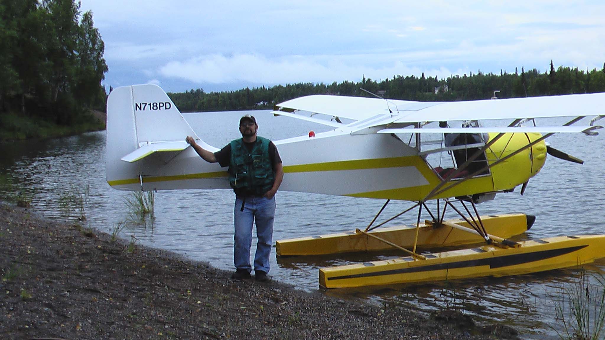

Posted: Tue Jul 31, 2007 6:52 am Post subject: Re: need engineer type to run a calculation |
the floats are a scaled down version of the northaires that were made of fiberglass. They are foam filled with no hatches or pump outs.. I am not fond of the foam filling or no pump outs, but they are on my brothers plane not mine! I have a set of the northaire drawings, and will copy them in autocad, then scale them to the dimensions he has. After that it will be easy to find the volume... now I just need time to model them in cad.
I installed the floats on his plane last week and did the test flying. solo it was great, but with 2 200+ guys, a full nose tank and 7 gallns in the wing, it was a bit of a slug to get off the water. she sat a little low for my liking, but most beaver drivers up here will tell you that any float left sticking out of the water is wasted revenue (only partialy kidding here).

well I had a brain cramp yesterday.. I have a whole dang engineering wing one hallway over..I got one of them to model the floats and run the calcs. It was a nice break for him from the hohum everday work. The model is not perfect as the cad software hit a wall for meging the compond curves (without getting the co to spring for the addons) but it is very darn close to perfect.
At the end of the day, the numbers are pretty close to my W.A.G. Each float is 12.874 square feet. At 62.4# per square feet that makes them 803.33 pounds (each) I was actually guessing around 700# each. They are still a goodbit undersize for the KFII at 950 gross (1050 on floats).
With these floats he has a good single place plane..
for those of you who like to see numbers I will attach a word doc to look at.
