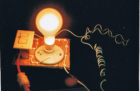

A long time ago I found directions on the list to build my own degausser. It wasn't hard and worked pretty good. I mounted a rheostat on a board with a large light bulb. From that I ran a long wire that I could wrap around the part with a magnetic field. Run the rheostat down to zero, the light bulb goes out and the magnetic field is gone.
I'll attach a photo. It's a little dark but the wire is wrapped around the axle.
I did this because I found that after cutting my axle in half, there was a large enough magnetic field that I could pick up one half of the axle with the other. I used this method to remove the field from these parts and form all of the tubing around the cabin.
