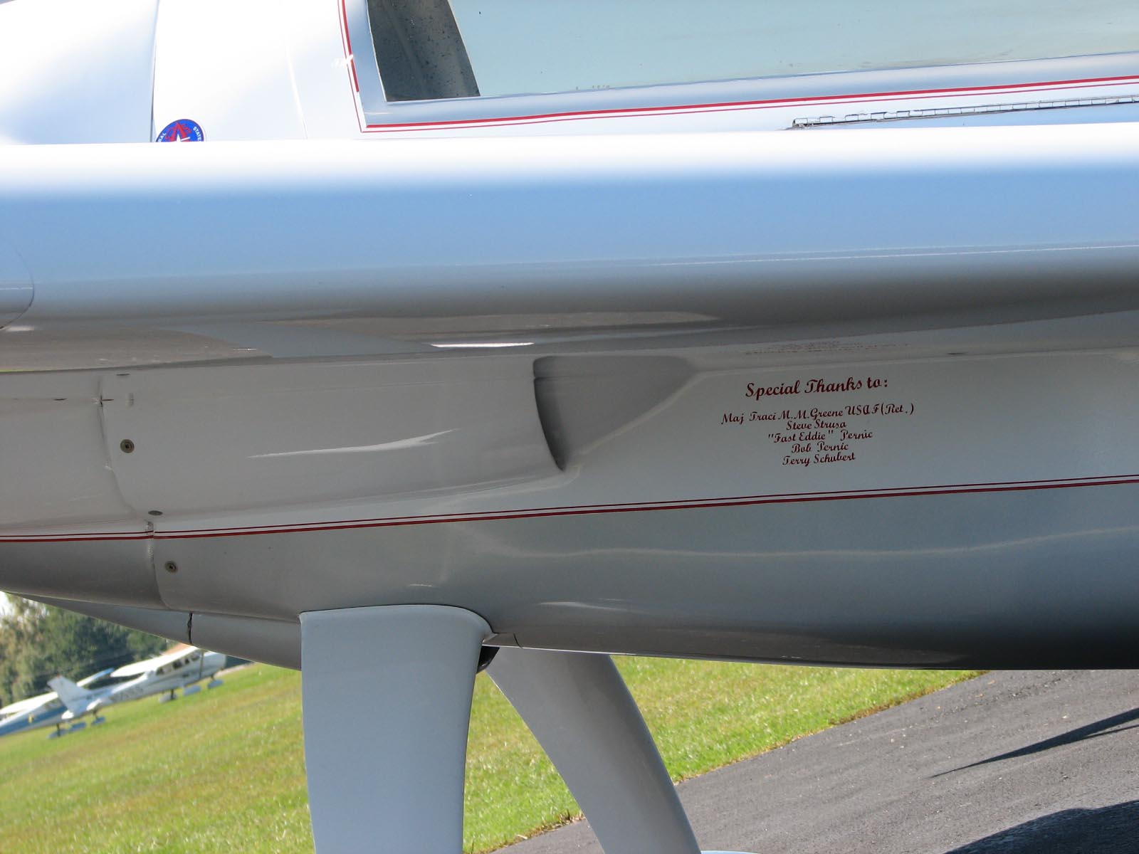

Have a look at the cooling air inlet on this Long EZ, this efficiently
cools a 160 hp Lycosaurus and only needs about 8 square inches a side to
cool all four cylinders. The key is pressure recovery and good sealing.

When I did the firewall-forward work, Andy Draper (at that time eith
EA2004) recommended that I closed the lower NACA - it should never have
been there for the 912/912S installations, he said, only for the 914's
turbo. As I recall our conversation, his point was that all this
additional air coming in at a place where it does not do any good for
912/912S, competes with the cooling air coming in through the cowl front
openings in getting out again. In other words, the more places you let
air in, the less air actually comes in through each inlet when the
outlet area is not increased. The NACA therefore effectively reduces
the air flow through the cowl front, which is the air flow intended to
cool the cylinders.
Your fix should therefore improve things, I believe.
> From what I can read between the lines, you don't have the Rotax
> glassfibre
cooling shroud over the cylinders and its (third) opening in the cowl
front?
As air in = air out, I trust you have already ensured that you have
maximum possible outlet area aft/below, without reducing the air flow
through the coolers?
Svein
LN-SKJ
Jeff wrote:
> On my cooling issues it's just a mater of too high of pressure in the
> lower cowl not letting the upper air from the top intakes down
> through. Until now the lower NACA was just shooting air into the lower
> cowl with no direction causing the this high pressure. John Hurst told
> me some time ago the demonstrator was set up this way and it was fine.
> This overheating never showed until this hot Tennessee heat wave hit.
> Again I believe I'll have it solved. I have glassed in the lower NACA
> to receive a 2 inch scat tube. This I will run to the upper part of
> the cowl. I hope it eliminates the high, lower cowl pressure and
> increases the top air pressure to force more air cooling down through
> the cylinders. I should have it all fixed in time for next weekend's
> fly-in at Rough River.
