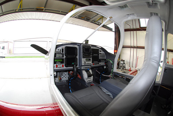

Has anyone installed one of the Lancair panels with the Throttle quadrant?
I am looking for pictures of one.

Posted: Tue Sep 04, 2007 1:42 pm Post subject: Lancair Panel |
Here are a few. Let me know if you want more offline. I moved the console back about 1" from what
the stock setting is to give my hand more room between the throttle and dimmer knobs. This
also meant all new custom cables for the throttle.

Posted: Tue Sep 04, 2007 6:12 pm Post subject: Lancair Panel |
Scott Schmidt has and it’s a beauty. I will forward a shot direct to your email address. Scott can give more details.

John
From: owner-rv10-list-server(at)matronics.com [mailto:owner-rv10-list-server(at)matronics.com] On Behalf Of RobHickman(at)aol.com
Sent: Wednesday, 5 September 2007 6:57 AM
Subject: Lancair Panel
Rob Hickman
N402RH RV-10 Finish Kit.
AOL.com.
