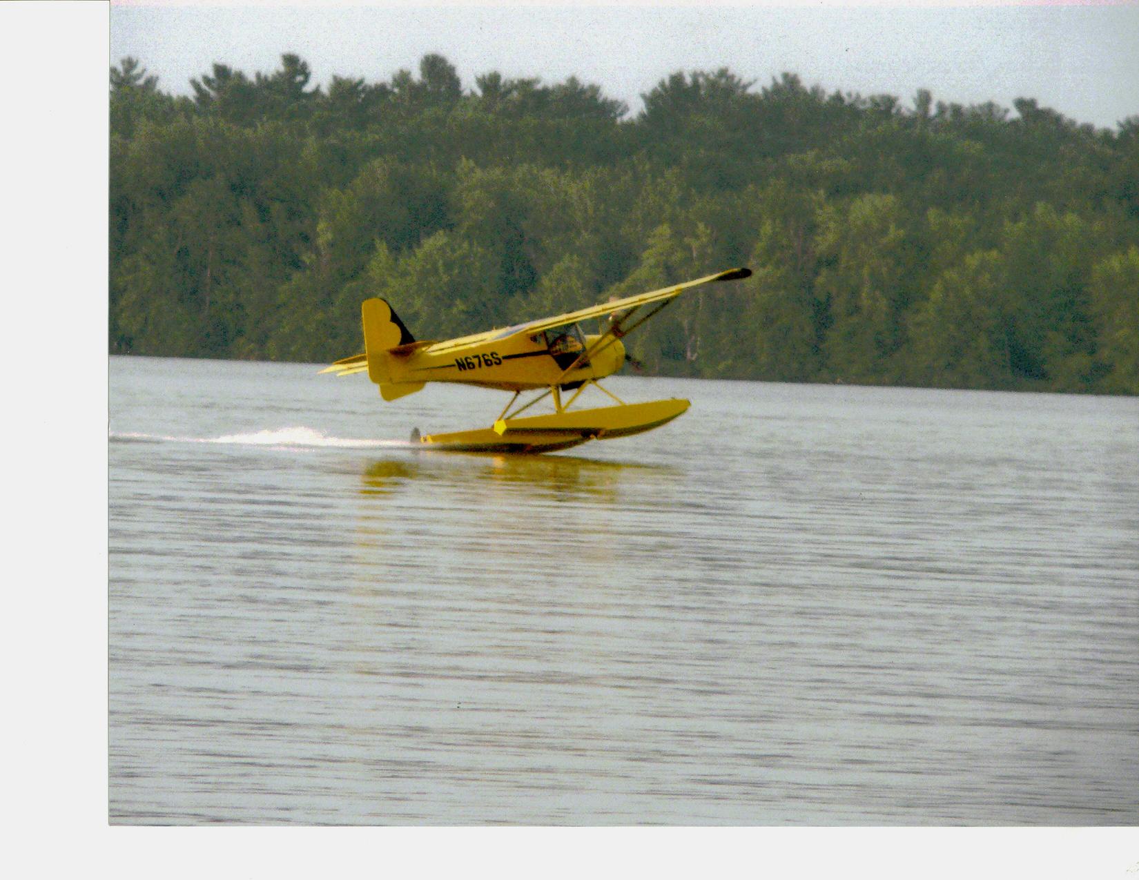

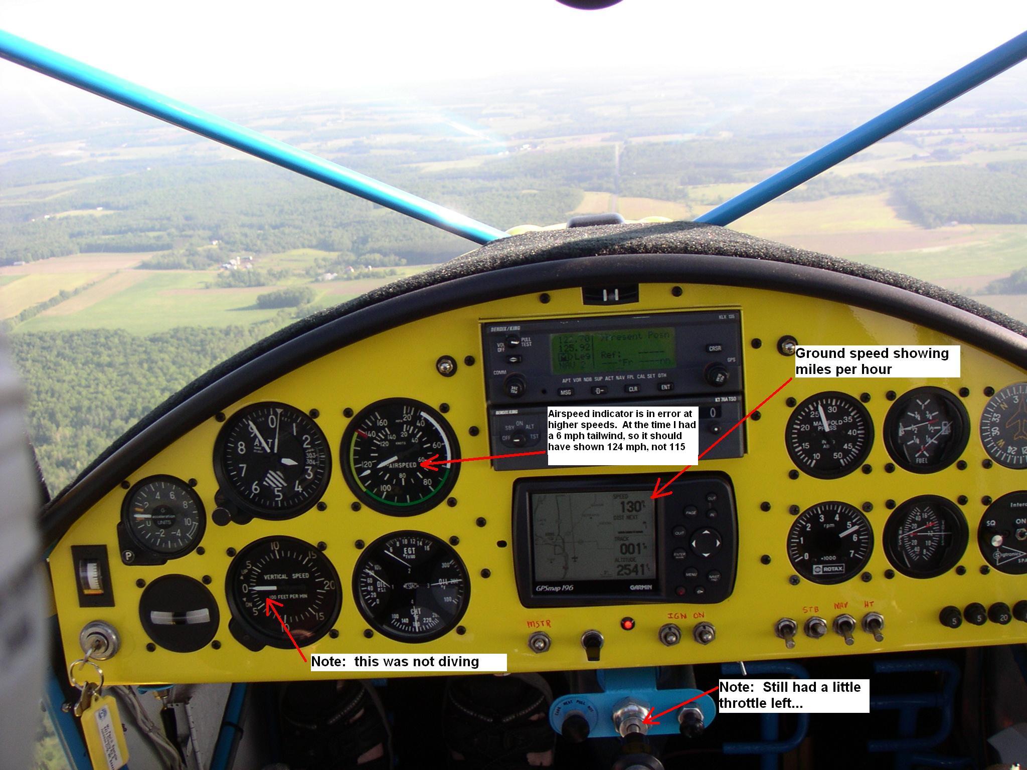

Leonard,
A light Kitfox (or Avid) with even an 80 hp 912 on a set of non-amphib full
lotus floats would be an awesome airplane.
I've flown a 582 Model IV on 1260 Lotus floats, and my IV-1200 on Aerocet
amphibs so I know what you could expect. While the 582 airplane is a fun,
good performing airplane (the one I flew had a warp 3 blade, but performance
was as you pretty much describe yours, maybe slightly less as no IFA on the
warp), the 912 with a IVO IFA will give you supercub or better performance
loaded or not (assuming you keep that IVO IFA on it - it definitely helps
get off the water). Mine is a HEAVY (776 pounds on the floats) model IV
amphib, but yet will get off the water at 1200 pounds (2 people, 3 hrs fuel,
and light on gear) in about 13-14 seconds on a 85 degree day, 5 mph wind, at
1200 msl. And it will easily cruise at 100+ mph. Tops out at 124 mph. I
do think the lotus floats would slow it down a bit (10 mph would be my
guess), but being non-amphib and obviously much lighter, would be a
rocketship off the water.
I like the Lotus floats for the same reasons you do, the ability to bump
into things without much concern. My dislikes are rough water capability,
step turning capability, general handling issues compared to a hard float,
Utraviolet damage issues, air pressue monitoring, and no storage
compartments. But they do work on our little planes.
Here are a few pics showing what my Fox does (I can't download or upload
video on my chipmunk powered internet dial up service, so this is the best I
can do...)
I wish I could as your video sounds cool!
