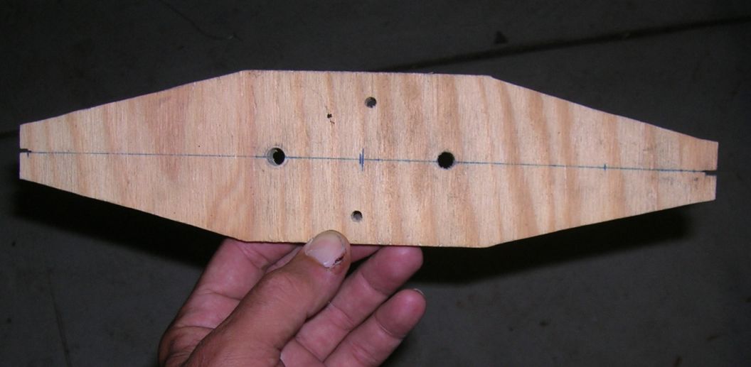

PostPosted: Sat Sep 29, 2007 10:54 pm    Post subject: New Warp Drive Reply with quote
I made an attachment plate from a piece of scrap plywood. The two smaller holes at 90 degrees to the centerline were used to test an old Soarmaster prop from the olds when you had to foot launch ultralights. I used .032 safety wire to suspend the prop being tested from a piece of square steel tubing I "C" clamped from the hangar frame and braced the tube with a couple of pieces of steel flat stock I took from my scrap bin. The whole apparatus took about 15 minutes to make. I used the stop watch I bought for testing Vx and Vy speeds during phase 1 testing of my mk 3 and repeated the test 3 times and took the average time. About the hardest thing about it all was trying to eliminate as much of any extraneous side to side rocking as possible. With a little practice I got pretty good at eyeballing the center mark as being in the center of the twisting motion. Once you get it moving with the center mark as still as possible you can count 30 swings, write down the time, count 30 more, write down the second time and count 30 more. Like any pendulum, as the arc gets shorter the speed the arc slows down. In doing 95 to 100 total swings to get three 30 swing tests each set was within a few tenths of a second for each of the three. With mounting and dismounting, I tested five props in about an hour and a half, and that included a break to make a pot of coffee in the middle of the testing.
Rick
