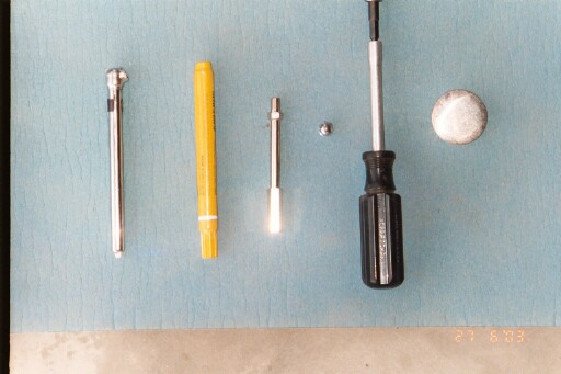

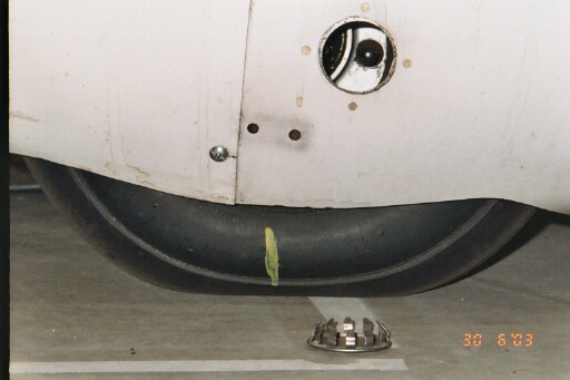

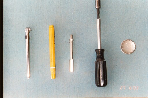

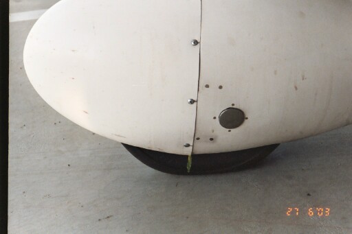

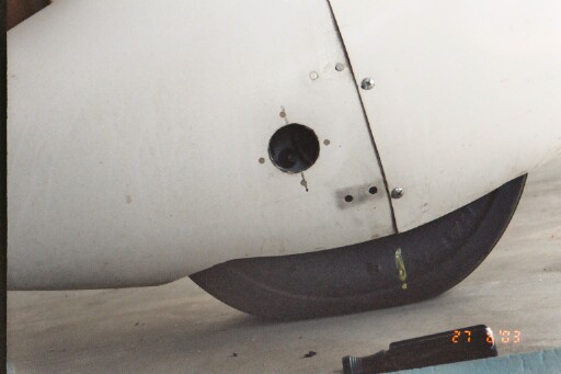

Here's what we did with HRII N561FS. as you can see this was before paint
and final finish work. Cut out a "donut" of .040 scrap to installed inside
of wheel pant fiberglass opening to hold the the plug note the four flush
"soft" rivets. Have done 4G's+, 250Kts & hundreds of landings...have yet to
lose a plug. KISS (Keep It Simple Stupid), looks good and it works
everywhere & everytime. KABONG 8*) Do Not Archive (It's in there)
