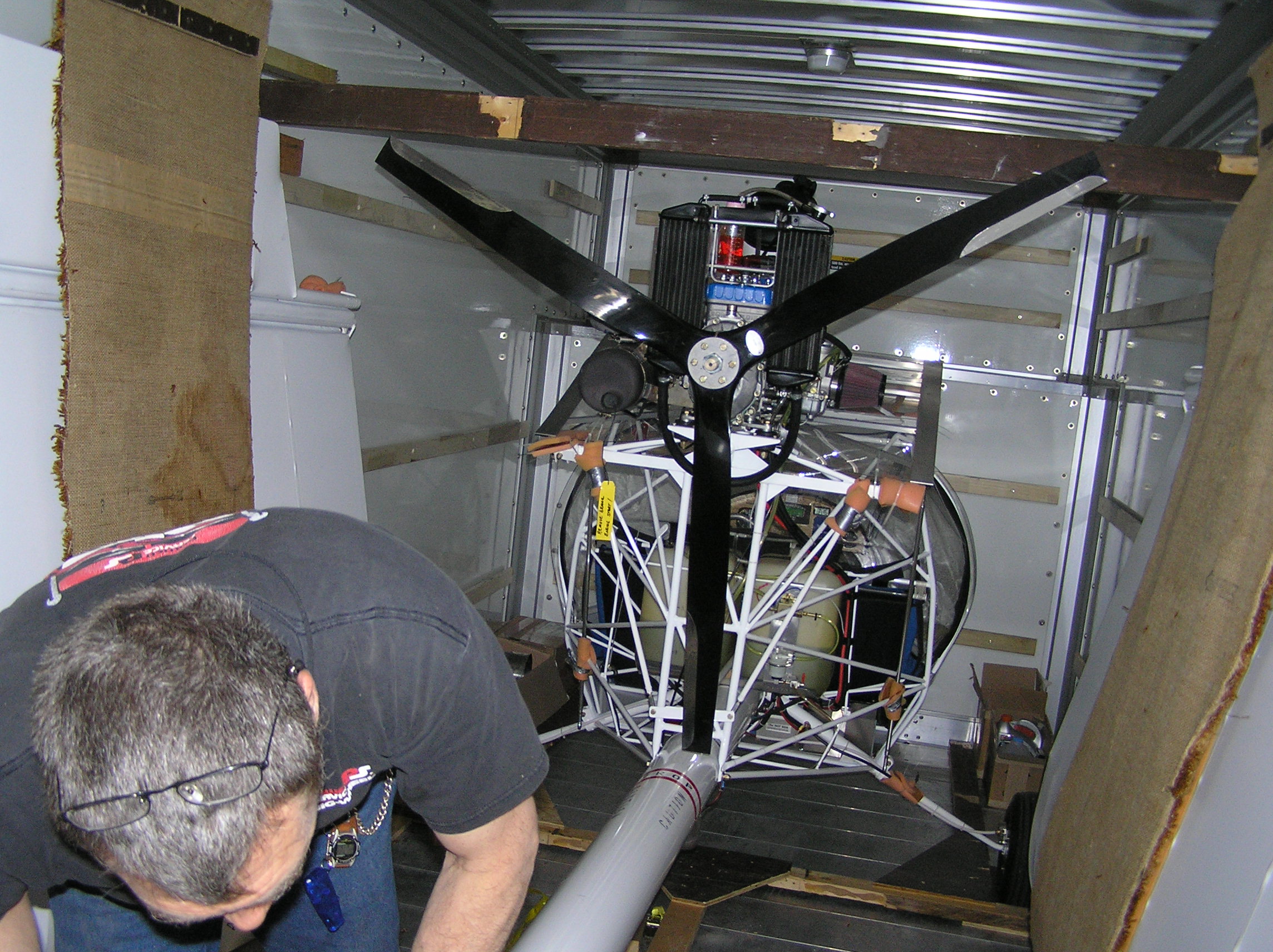

I brought my MkII home to PA from Northern Wisconsin in a 28' rented U-Haul. And a detour down to Dayton so I ended up with about 1300 miles on it. When I unloaded I hade absoulety NO hanger or trailer rash. Attached are some pictures of how we rigged it.

For some reason I could only get one image to attach. So here is another one. Wings were hung with foam, carpet and 1" nylon safety straps. Wheels chocked and boom put on a rest.

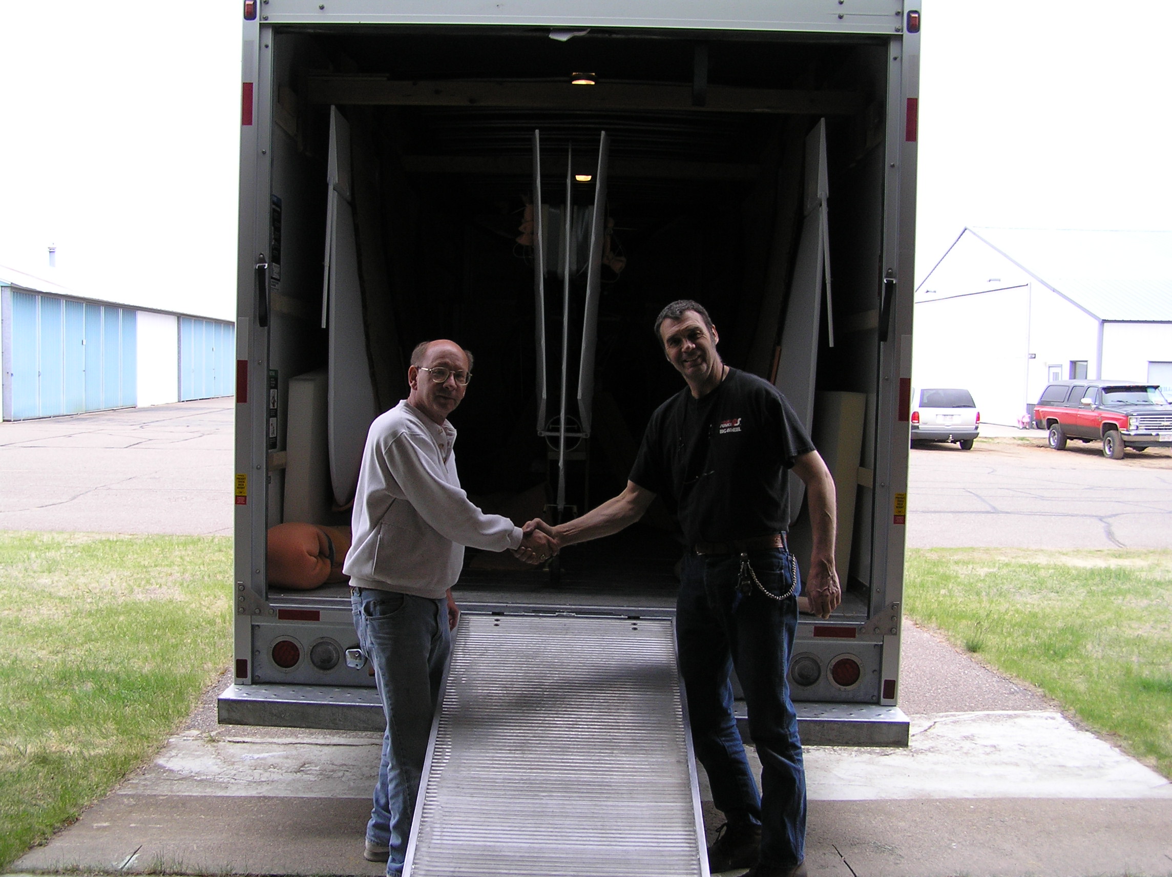

Last one. That's me on the left and Dick Neitzel, builder, on the right.
