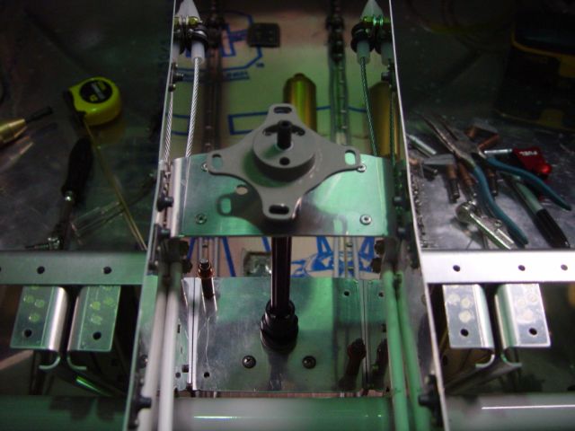

MauleDriver(at)nc.rr.com
PostPosted: Thu Oct 25, 2007 8:20 am    Post subject: Andair Fuel Valve - current sources? Reply with quote
I've been running the auto-configure tool and it looks like they added
the 90deg elbows to it. So what I end up with is (2) built in 90deg
elbows, exiting the FS20x7 at 45deg angle forward, then with end of the
elbow angling 45 deg rearward. It still sticks out a ways, so I'm
going down to check the clearance now.
I'm thinking that the custom version that ZackRv8 posted pictures of
where the 90deg elbows are pointing downward along with the feed line to
the engine might be optimal from a width perspective. But the depth
issue is not clear to me at all yet. With the extension, I understand
you want it low enough to allow the 2" SCAT to fit on top, and I guess
high enough not to interfere with the elevator pushrod and stuff. Just
not clear on the total picture yet.

PostPosted: Thu Oct 25, 2007 9:03 am    Post subject: Andair Fuel Valve - current sources? Reply with quote
Surprisingly, I didn't find clearance to be an issue with the elevator
pushrod stuff. Having it down low enough for the SCAT tubing is
very nice though.

Seems the path of least resistance is to use the Vans offering and route the rear cabin heat via the original path. With the input fuel lines 90 degrees apart and the center output port, you should also be able to route the rear heater cable through those lines also as an option.
William
http://wcurtis.nerv10.com/

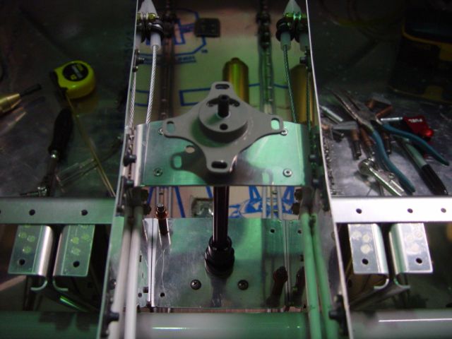

I purchased my valve from Neal and thankfully he knew all the parts that
were needed for the extension. I probably would have ended up ordering crap
I didn't need. I attached I pic of my extension setup.
