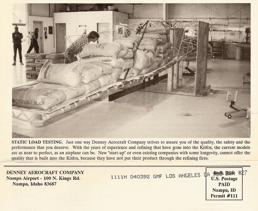

The second file "KFwing-load.gif" was on the back page of "Kitfox
Times" another publication by Denny Aircraft dated Jan/Feb 1992. I
seem to remember details mentioned with this photo from another
printing which defined the weight of the sandbags and the simulated
G load. I may be confused so don't quote me about that.

I have the same document that Rex provided you as well as another one if you look that will read " at 950 lbs maximum , the Speedster is capable of positive G aerobatics, ultimate load limits of 9 g _ and 4.5 G - " it is scanned and poor quality but i will try and get a better scanned copy.
With that being said the Speedster has wings that are 1 1/2 feet shorter each so the outboard flex will be a little less than on the long wing model..
