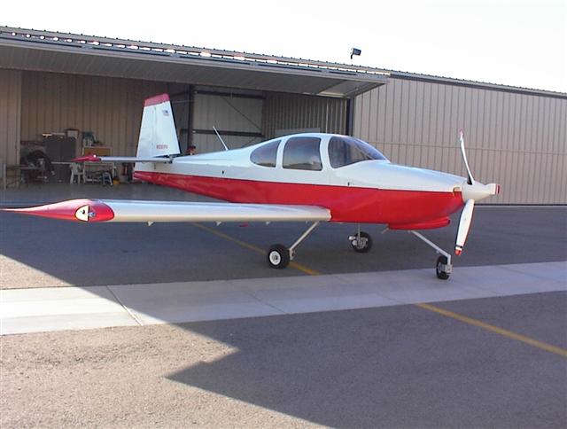

N991RV first flew on 10/23. 4 hours now but oil temps are too high – 245 – so I’m trying to fix that. Otherwise, it flies great, just as I hoped. What a plane!Albert GardnerYuma, AZ

Kuddos - beautiful paint job too. You are an inspiration
to all other "older" builders. Hope you get the oil thing worked out
without too much hassle. Did you use the Vans or the oversize
oil cooler? Very Happy Very Happy Very Happy Very Happy Very Happy Very Happy Very Happy

This isn't to pick on Albert, who just started flying, of course. But,
After starting with high CHT's that would get easily over 410 in climb
even when solo and now having it stay well in the green with the whole
family on board, I can tell you that the builder has a lot to do with
the temps. I KNOW that I didn't do as good a job initially as I thought
I did. During the original build, you look at things, and they seem
to look fine. Things like how well you sealed around your prop governor,
and how nice your cowling ramps were done, and nobody even thinks
about between-cylinder casting crud. Then, when you realize you have
an issue (which just like many problems, first you have to *admit* you
have a problem), then you start to look very critically at things
again. I easily dropped 30-40 degrees on my plane after being diligent.
Also, during initial assembly, as you get to the engine and final
stages, the motivation to fly starts to overwhelm you and you start
to get builder-tunnel-vision to some extent...and that catches up
with you too. Truly, for many people, once you start to fly, you
can easily use up 40-60 flying hours of tinkering with your avionics,
systems, and engine to get everything perfect. Even to this day
I occasionally have things that I think can be improved. In a few
days I'll be writing one of them up.
As for why does it vary between planes.....well, the major difference
is that builders vary, but so do engines, props, cowls, and so on.
ALL of them can be made to work well, from what I can tell, but the
builder is the major factor. Even with the James cowl, that supposedly
promised more Knots and less Heat, the offline comments I've gotten from
a couple of flying James cowlers indicate they have speeds the same as
the other cowl, and actually have heat problems as well. Can't really
blame the cowl though until the builder does their diligence....and
once they get their mind around it, I'm sure things will improve
too.
There are a few planes out there with Louvres on their cowls, which
for some may actually be needed depending on the severity of their
environment. For many though, I think they're just a band-aid for
sub-par baffle work. I'd say fix the issues as best you can the
proper way and THEN see if you need them.
Anyway, the builder....that's usually the difference, and it's not to
insult anyone at all. I myself was in that situation.

I'm going to float my opinion, so take it for what it's worth. I think the cause is poor baffle seals, and the difference between planes is due to difference in the sealing. Let's face it, using the upper cowl as the top of the plenum is a poor choice to start with, and it only goes downhill from there. It's not a new problem, even the certificated ones don't seal well once they age a little. Sealing all the baffle leaks is the biggest high temp killer you have.
So, what's the solution??? Mine will be to add a fiberglass (or carbon fiber) sheet to make a plenum from the air intakes to the back of the engine, using the stock baffles minus the baffle seal material. I'll pay particular attention to the area around the starter and all the areas where the aluminum baffle material meets the engine. One other overlooked area is the gap between the spinner and the cowl. Air comes into the inlet, and is sucked forward around the flywheel and then out between the spinner and cowl. To seal this area, take some foam pipe covers .... the type to prevent pipes from sweating and glue it in a ring around the area just behind the spinner. A really tight fit is good since on first startup it becomes self forming.
