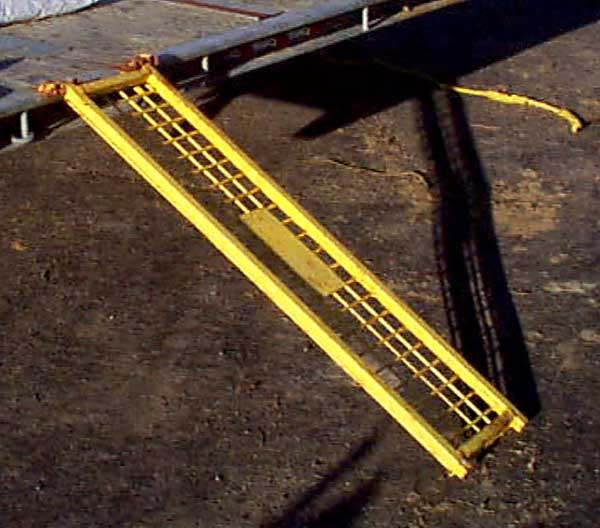

To begin the trailer at the rear lip when on my quad is 23.5" high to the top of the platform. If it were on the car it would be around 24" high. The ramps are constructed of 1" X 1" steel with class A crusher screen forming the tire surface. The ramps are 47" long and 10.75" wide. I used small pieces of 1X1 stock welded to the back lip of the trailer to form the hinges for the ramps.

This picture shows the general construction of the ramps. Each place where the screen touches the frame was mig welded.

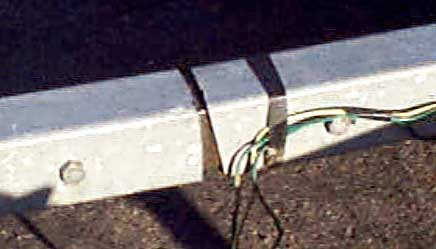

[img]cid:174533519(at)06112007-07B0[/img]
A close up of the cleats I welded to the trailer. 5/16 bolts hold the ramps to the trailer and form the hinge. I also had a temporary block behind the hinge on the deck for towing the trailer with the ramps in place but without the plane.

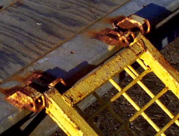

[img]cid:174533519(at)06112007-07B7[/img]

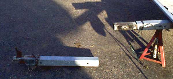

A close up of where I cut the tow arm... So I'm not too good with a cutting wheel. This picture also shows the 1/2" bolts I use as tow pins. They are held in place with cotter pins only as the load is completely shear.

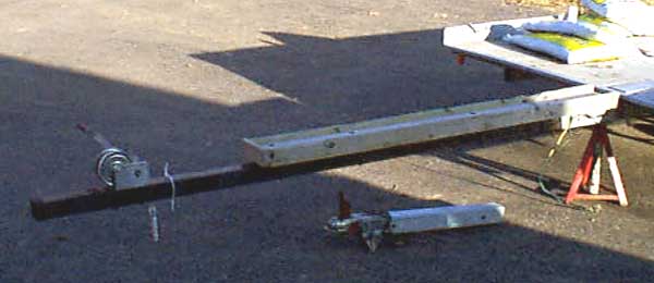

[img]cid:174533519(at)06112007-07BE[/img]
The tow arm is off.

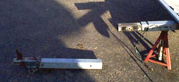

[img]cid:174533519(at)06112007-07CC[/img]

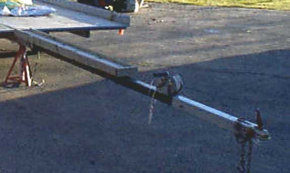

Extended tow arm in place. Note the platform (2X6) for the tail wheel to roll in while loading/unloading.

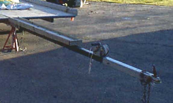

[img]cid:174533519(at)06112007-07D3[/img]
Long tow arm installed and locked in place les than 20 min. Tools: ball peen hammer and a bit of chain lube to ease inserting long arm. The elongated arm is a lot heavier stock than the original tow arm. I use an extension cord (four conductor) for the trailer lights.
Dimensions for the deck of the trailer are 10ft. long and 8'5" wide. The trailer is designed to carry two full size snowmobiles which can weigh close to 700 lb each. when I set up the trailer for the first time and measured where to put my wheel blocks I rolled the plane back until I had around 50 lb. on the hitch. It towed the plane beautifully. With that long arm backing up is also easy.
