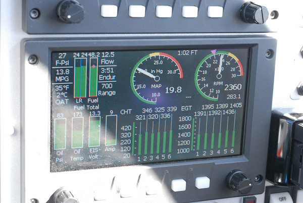

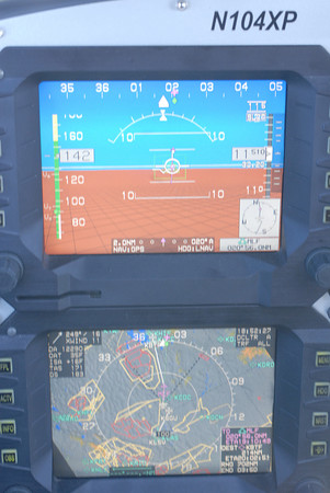

At Nellis, the most asked question on Saturday and Sunday was, "Does this plane really cruise at 170 knots like the ad says?"
I probably got this question about 6 times and I'm sure everyone else wondered the same.
I told them it does and it will do more depending on how much fuel you want to burn. It is funny that people don't believe it.
Now at gross weight and cruising at 10,500 - 12,500 ft. I get about 160 - 162 knots, but if I went lower and pushed my fuel burn up to 14-15 gph, no problem.
177 knots is awesome. I will have to load the plane up someday and scoot across the ground at 800 agl (5000 ft.) and see what type of speed I can get.
Here are a couple more shots just to prove that this plane will cruise at 170 knots. Here I am running ROP at 12.5 gph at 11,500. The TAS is 171 knots.
I should tell people the ad lies, it is actually faster than that.

177 seems kind of high to me, but that's what EFIS said and I'm as sure as 45 hours of experience can make me that it's right. I wonder if having a lot of nose down trim was a factor. I've heard that being tail heavy is more efficient because it unloads the main wing, but then again the lift (and induced drag) has to come from somewhere, even if it's from the tail.
I dunno. I'm anxious to get out there and get some more data, and see some cool stuff like those mountains, Scott.

For me, the biggest thrill has been the benefits of running LOP with
a good engine monitor. It's amazing, but I can even cruise around
at 125kts indicated while at 3000' or so, and get the fuel flow down
to about 7gph....so it'll do better than a cessna for your local
sightseeing too if you want it to.
Oh, and last week, when Scott took my kids and had more in the
back, he seemed significantly faster than me and my wife alone in
our plane. But at OSH, he only seemed about 2-3kts faster. So I'm
guessing loading played a factor in that.
One thing I'd love to hear from you after you get some cruising done
is what your favorite RPM is. So far I've heard from at least
2 RV-10 builders, with 2 different props, who both like the feel
of 2360rpm. Not 2350, not 2370...it's very interesting to me that
some of us can find some of these same sweet spots, and I'm wondering
if there are more who find that and we don't even know.
