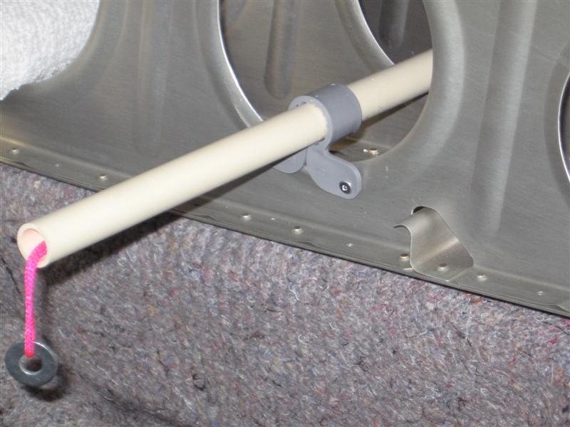

See the attached picture for a different solution. I had quick-build
wings so I used CPVC and pipe suspension hangers. The wing is upside
down in the picture.
