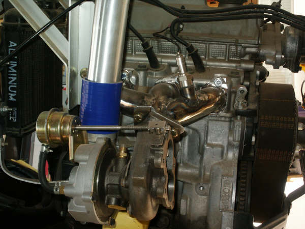

And my mistake, too. The VW based engine I was referring to that had the turbo was made by RevMaster. When I checked out the website, I noticed they are direct drive. Boooo! Then I went back to Great Plains and looked at their engines. I think the water-cooled heads, redrive version would be an awesome way to go.
I think I did see somewhere where you may be able to put on the redrive unit from someone else on the RevMaster engine. Like, buy a RevMaster engine, and put on a Great Plains redrive unit. But, like you said, it may not be necessary.
Since we are talking about a Kolb installation, it appears the reduction unit would likely be the 1.6 to 1 version. They say that engine would produce 400 lb. of thrust with a 72 inch prop. That sounds like a lot to me.
Along time a go (5 years) I had my GEO 3 cyl/redrive engine and Ivo Prop running and fully operational. I did not do any thrust tests on it, but I can tell you one thing, the forest thought a hurricane was a'blowing. I have mounted my turbo unit (Garrett 1544) on my homemade tiny exhaust headers. Cute as a bug's ear! They fit in the palm of your hand....and you can almost see fingers sticking out past them. The turbo is a super small unit, made especially for 1000 cc size engines. The entire turbo is about the size of a Nerf foam football.
I hope to get back to my engine in about a month. I'm looking forward to seeing if the turbo shows a noticible difference.
BTW, Rick. You did fly the direct drive VW motor. Yes? And now you have the reduction drive. Is this the same motor, with an added redrive, or an altogether new one?
Here is a photo of the turbo in progress.
Mike Welch
