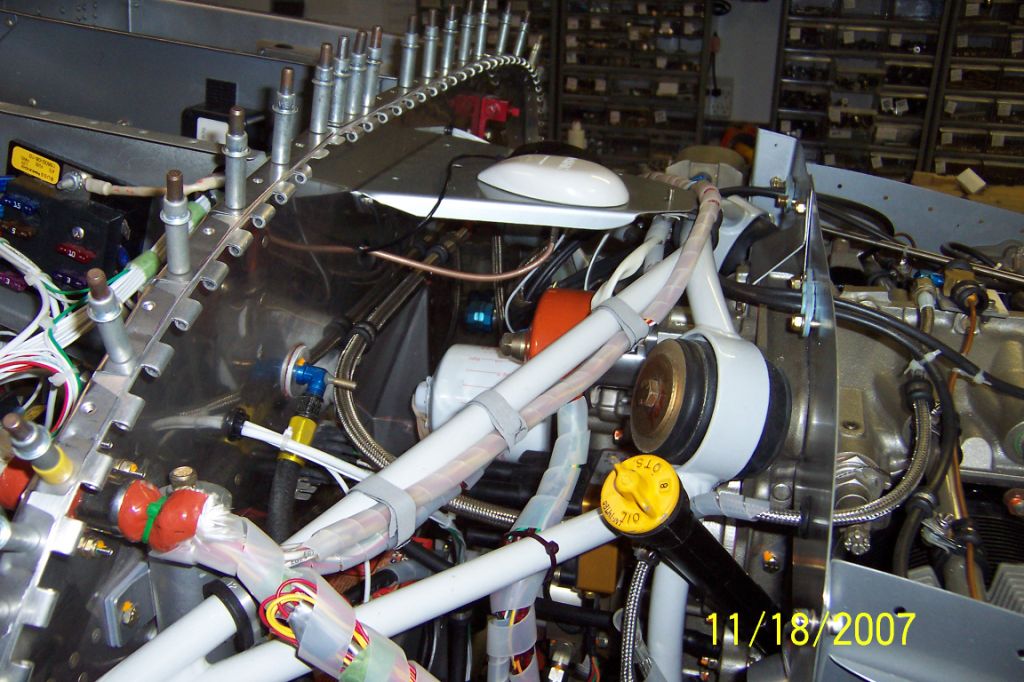

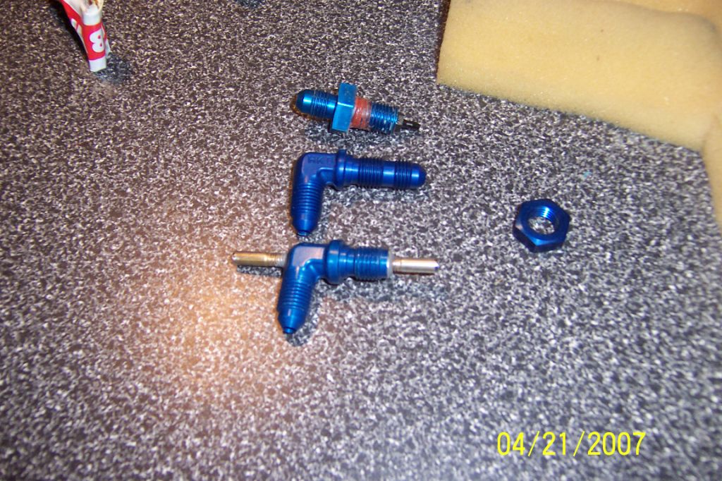

Ron, there was a fitting in the Vans kit with a 1/8 hose end on it for a manifold fitting but I also needed a manifold pressure source for my P-Mag so I just modified a 90 degree bulkhead fitting to do both. I took two short 3/16 bolts, cut the heads off, and used a 40(?) drill in a drill press to go right through the bolt to make it hollow. Then I just drilled the bulkhead fitting and threaded it for the 3/16 bolts and put a little JB Weld on it to be sure. Used regular manifold line (#6 I think) to right rear cylinder. Be sure to put the restrictor in. Total time was about 20 minutes as I remember it. Pictures should tell the story.
Hope this helps.
