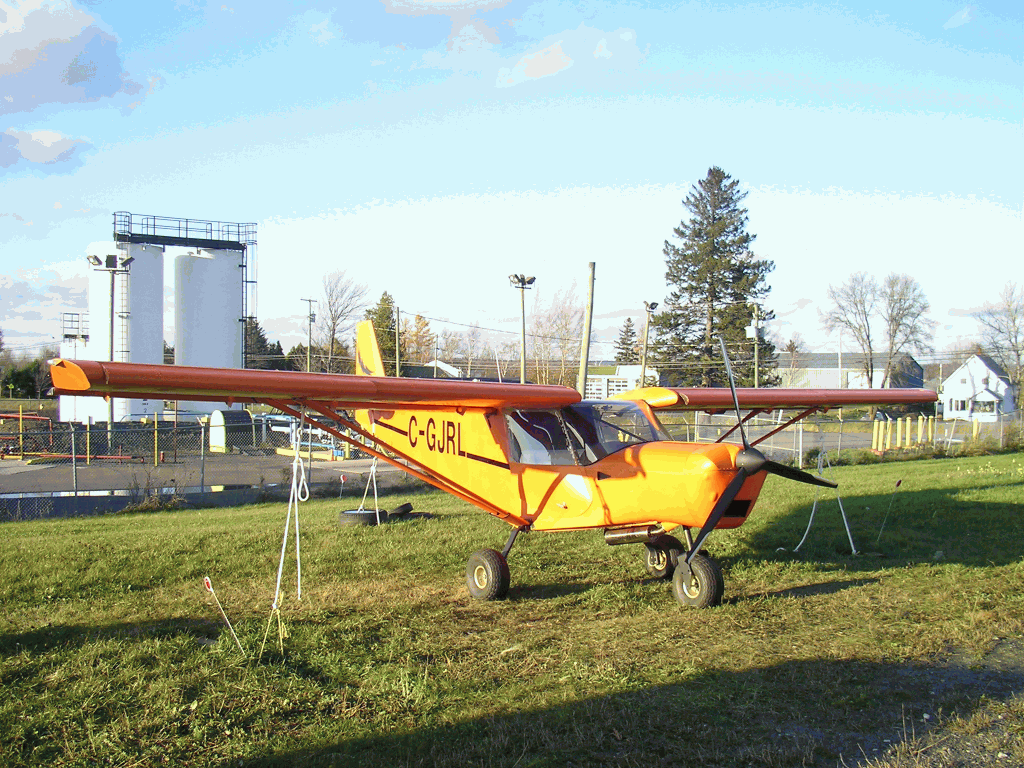

C-GJRL finally flew yesterday. It has in-flight adjustable prop. I had done a crow hop on Sunday with the prop at min pitch and flaps up. That required full back stick to flare with no margin. The min pitch was way too fine… the engine was not being loaded at all and the plane barely hauled itself off the ground.
For the flight yesterday, I set the pitch to midway and took off with half flaps (nominally 15 degrees). That was a much better setting. It climbed well.
I was pleased with the lightness of the controls and their balance. Used half flaps for landing as recommend for the Pegastol wing. The landing was easily controllable with plenty of stick margin on the flare.
The aircraft trimmed way too nose down even with max aft trim. It is true that I was near the forward C of G and the forward limit for the Pegastol is set at 10% of Mean Aerodynamic Chord as opposed the standard 701 which is a 20%.
Regardless I will be doing the elevator edge bend removal that others have found useful in these situations.
I am waiting for better weather to fly again. I am in New Brunswick, Canada which had freezing rain today and snow flurries forecast for tomorrow. Sigh.
 Filesize:  342.78 KB
 Viewed:  1189 Time(s)

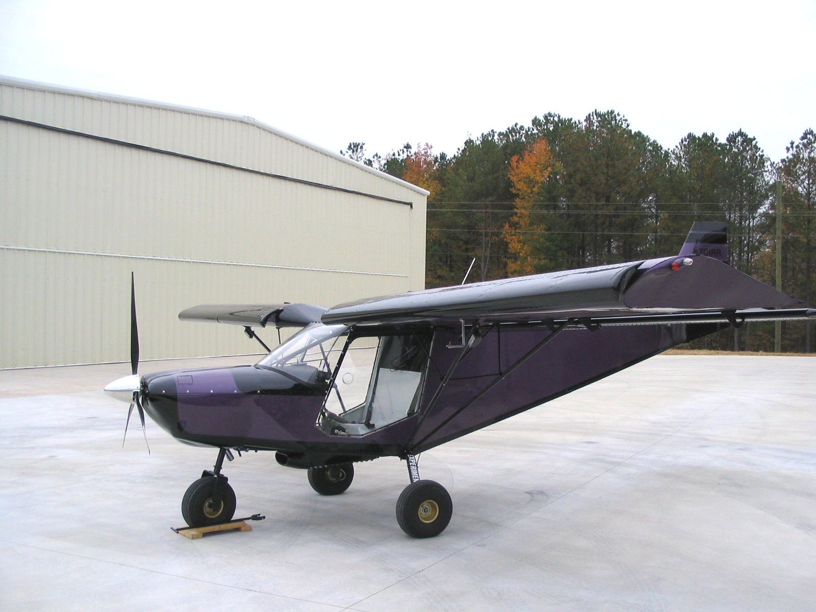

Congrats Ray! Keep us posted on that 1.3L. I too have the IVO inflight adjustable but I used the ground adjustable hub for my first flight setting the prop at 10.5 degrees. Max RPM was about 5400....
Can you send me a photo of how you mounted your hub brushes?
