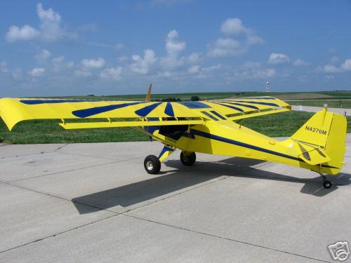

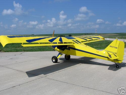

Here are some photos of what I am looking for does anyone have any used ones before I look for new tips. It almost looks like there is more than one type of tip in some other Photos I did not attach because they were not "N" numbered and I figured it would cost to much to have them shipped over seas.

Yes the are the stock droop tips on the KF models I - II - III, if you don't have them count your blessing. I would gladly trade you the droop tips on my plane for your horner type tips in a minute, but alas they won't interchange

Cause I'm tired of hitting my head on them when walking around the wing, you can't see they limit vis. they are just plane ugly do nothing to help the plane fly, if you drag a wing tip you will bend the rear spar they are ugly guess I already said that.
