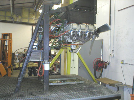

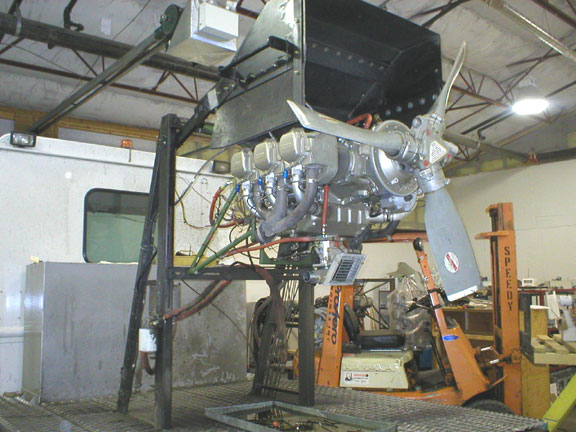

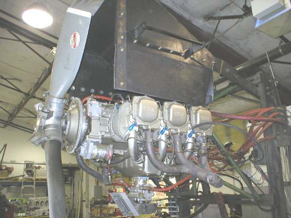

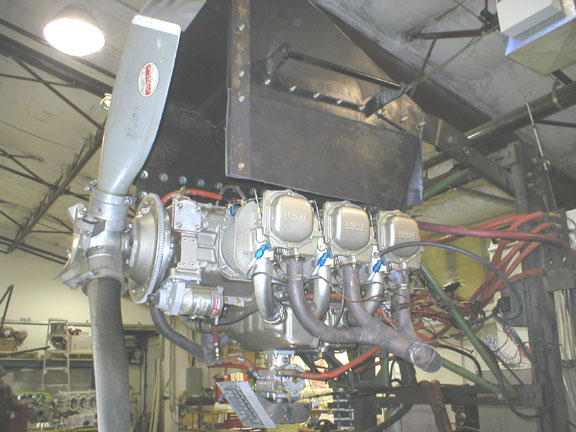

PostPosted: Sat Dec 01, 2007 5:02 am    Post subject: Engine Choices (Taxi Testing New Engine) Reply with quote
Hi Deems,
Attached are pictures of my engine on Aerosport's engine test stand, which is on the back of a truck so they can run it outside.
Boy I can't remember exactly, and my records are at the hangar, but I think they ran it for nearly 4 hours on the test stand. I seem to remember they had an entry where they ran it somewhere around 45 minutes at 2750rpm on one run.
Wayne Edgerton N602WT
