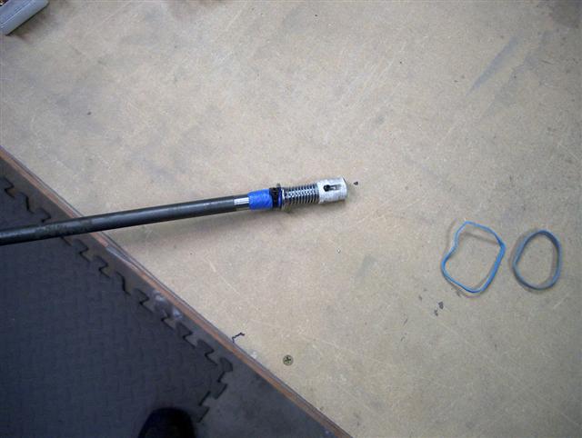

If you are referring to the rivets holding on the bottom skin right next to the flap attach arms (I think there are 4 on each side) I used a long backrivet set with the collar removed. Do make sure the face is polished very smooth or it will mar up the skin pretty good. Be sure to be perfectly perpendicular too as the edges have no bevel or curve in them. Turn up the air pressure cause the long set absorbs a lot of impact.
I actually made my own backrivet set out of a 12” long cupped set that I got on ebay (see pictures attached). It came with a gaggle of sets and bars that were for a rivet sizes I’d never heard of. I cut the end off flush and polished the thing up real good. At home depot I found a pvc fitting that fit it like a glove and cut it up to work like a standard backrivet set. The spring that came with the avery c-frame seems to work pretty good holding pressure on the pvc fitting.
-Ben Westfall

If I didn’t make it clear the backrivet set was used as a regular set on the manufactured head of the AN470 rivet and my wife bucked the shop head per usual.
-Ben

I noticed in the Avery catalog that they sell a rivet gun extension, 8" which a flush set can fit into. I plan on purchasing it and then I will also get another 3/4 diameter flush set and grind a flat spot onto one side so I can get the center of the set closer to the rivet head. Shouldn't need to take too much off the side of the set because the anatomy on the shaft might mar up the flap attachment bracket.
Obviously, I'll put some good pipe tap over the ground off edge and shaft.
This should allow a good set of those rivets.
JOhn G.
