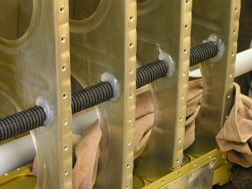

It's got to be tube first: isn't it recommended somewhere that at each rib
you have to 'proseal' or otherwise attach it to each rib (maybe a
silicone/RTV adhesive) to combat chafing
John (RV-9a - wings)
| | - The Matronics RV9-List Email Forum - | | | Use the List Feature Navigator to browse the many List utilities available such as the Email Subscriptions page, Archive Search & Download, 7-Day Browse, Chat, FAQ, Photoshare, and much more:
http://www.matronics.com/Navigator?RV9-List |
| Back to top |
JOHN TIPTON
Joined: 17 Sep 2006 Posts: 239 Location: Torquay - England
Posted: Mon Nov 19, 2007 2:09 pm Post subject: Wiring conduit and lower skin riveting - RV-9 Wings |
PS: Like this --- See attachment
John

Place the tube first. Then rivet. it's no big deal to get around the
tube.Also, you might want to place a dab of proseal around the tubing at
each rib.

The conduit was difficult to pull through the holes, so I didn't bother to glue it to the ribs as I see no way it could ever pull out.
Also, were I to do it again, I would route the conduit along the upper part the rib, not the lower. It was a small pain to get the bucking bar between the bottom skin and conduit.

Yes they are had to pull through but you glue them in place to keep them
from chaffing and being cut by the rib because once that happens, the
wires are soon to be cut.
Bill
