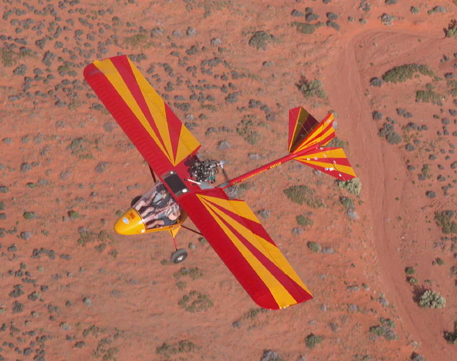

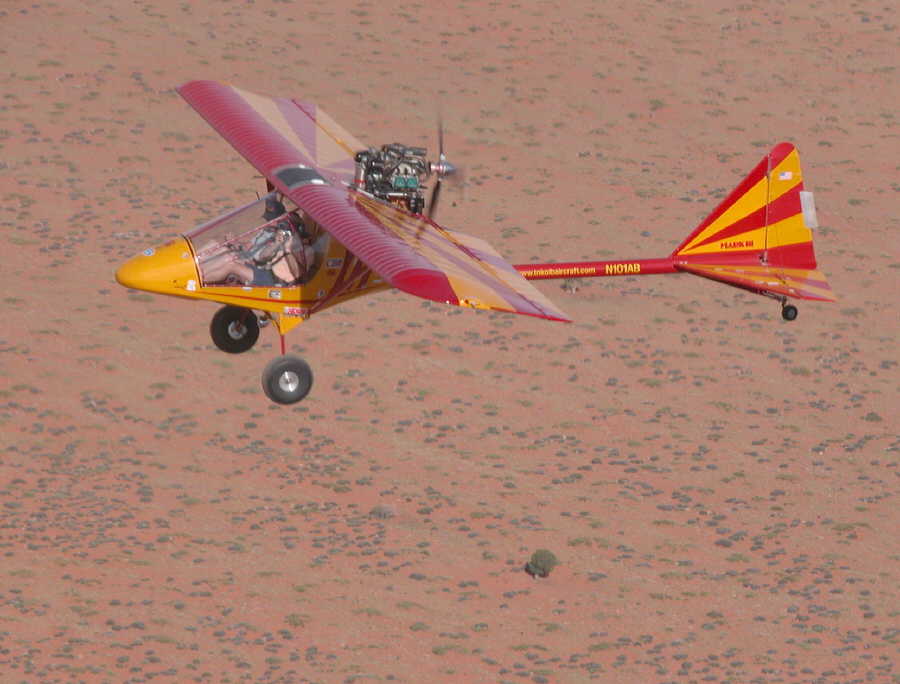

You can mount a BRS soft pack in the center section, rocket and all. Absolutely clean.
As far as wings folding, I know of one case in my 24 years of building and flying Kolbs, where the wings folded. That was the Twinstar (IIRC) that flew without the 3/8 bolts in the main spar H braces. Only thing holding the tang was the few 1/8" rivets that kept the tang in line. He made the maiden takeoff with wings and landed with the wings folded. RIP
Attached photos were taken by Larry Borne, I think, flying as a passenger in John Williamson's Kolbra at Monument Valley. Please correct me if I am wrong.

Yup, that were Monument Valley. The 2 Johns were the pilots while Jim Hefner in John Hauck's Miss P'fer and I in John Williamson's Kolbra took pictures of each other. Fun Flight ! ! ! Lar. Do not Achive.
