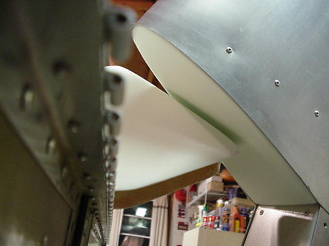

You can make a rib out of .016 aluminum or take a look at this method and
see what you think - it's only one other way to tackle the problem. Works
for me but everyone has their preferences:
Even builders of metal a/c need to cultivate a skill with working in
fiberglass.
Take a piece of builders foam (often scraps are thrown away at new home
sites); usually this stuff is blue, green or pink, and is available in
various thicknesses from 1/2 inch up to 3 inches. You need a piece of one
inch for this.
Press foam against rudder spar and then into the open bottom end of leading
edge - this will leave an impression of the opening.
Cut out this piece on the bandsaw and sand (the stuff sands easily) until it
is a somewhat loose fit into the area to be filled. If you ended up putting
a gentle curve into the bottom of the leading edge to fit the saddle it
won't matter as you can easily sand the side profile to match.
Cover the top surface of the piece (draping some cloth over the sides) with
a layer of 5 to 8 ounce fiberglass. One layer will do for this piece. Use
finishing resin which you can get in larger qualities from ACS or go to
local hobby store (Tower Hobbies for mail or on-line orders) and see what
they have. It's normally one-to-one in ratio from the hobby store venue.
Apply with the cheap acid brushes you get at hardware store for $.49 so they
can be tossed - though acetone will clean 'em if you want to reuse.
Allow resin to set and scuff a bit with 50 to 80 grit paper, then apply
another coat of finishing resin.
This should be sufficient thickness to allow sanding to a smooth surface; if
not, apply more resin. Start with 80 grit and move to 220.
Sand edges carefully checking often for fit into the rudder opening.
Attach into opening with RTV (the RV crowd uses this all the time). Mine
has held through 310+ hours.

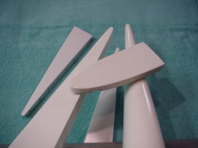

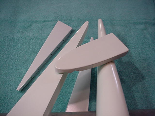

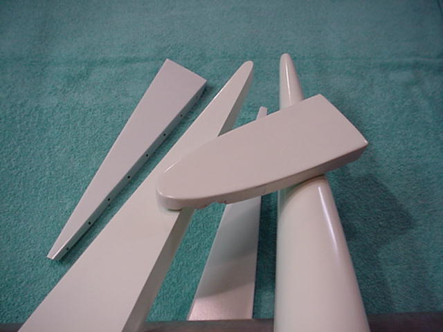

The "rudder plug" is shown installed in one attachment and sitting atop the
stab tips in the other (providing the attachments come through).
The stabilizer tips are another easy fiberglass project that clean up an
area in the tail surfaces. I did not care for the look of a row of rivets
running to the aft end of the tips and the creases formed by the rib running
the rear length.
Take the same process as above: trace around the aft of the stab tip, cut a
piece of builders foam, epoxy in place, sand with a big block, cover ONLY
the foam being careful to keep the piece of cloth just large enough to
extend past the edge. When the resin is almost cured you can take a
single-edge razor blade and trim the fiberglass "whiskers" off. The reason
for this is to minimize the amount of sanding needed on the gel coat of the
tips.
The ribs that would have been used can now go into the elevator where the
rudder cutout is (mine is an HDS; the XL kits may come with extra ribs for
this purpose?).
In the second attachment the tips are shown, the plug for rudder is atop,
and the cutout ribs are the ones with rivet holes. The primer is Randolph's
two-part epoxy, Epibond.

PostPosted: Mon Jan 07, 2008 5:45 pm    Post subject: Re: Adding extra rib to rudder Reply with quote
Just make sure it's attached well so it doesn't come partially out and interfere with rudder travel.
