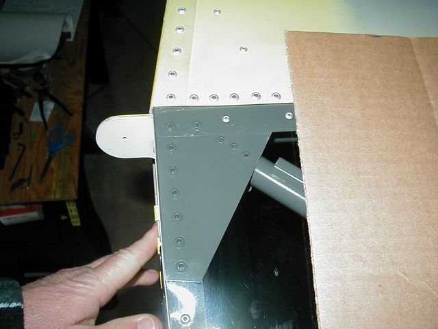

PostPosted: Thu Jan 10, 2008 8:38 am    Post subject: (CH-701) Anyone else have edge distance issues with 7F3-3SP Reply with quote
John,
I don't remember any real issues with this, although I probably looked at it
for quite a long time trying to figure the best way to do this.The rivets are very close together
but the plans call for this. You can see in the pic, the one rivet is a little further apart from
the rest so it would line up with other rivets and the other 3 are grouped so I would not
hit the edge of the top fuselage skin and still had edge distance on the gusset.
It is tight though. Picture attached.
Brian Unruh
Long Island, NY
http://701builder.com
When I drilled out the holes that connect 7F3-3SP with the diagonal tube the
distance between the holes was unacceptable to me......Anyone else have this problem?
I could not find anything in the archives
about it.
Thanks!

PostPosted: Thu Jan 10, 2008 10:29 am    Post subject: (CH-701) Anyone else have edge distance issues with 7F3-3SP Reply with quote
Thanks to everyone for the feedback.
I know that the designer can violate edge and spacing distances, but the rivet heads would have been overlapping in my case.
The new part I fabricated has about the same spacing as this photo.
Thanks again!
