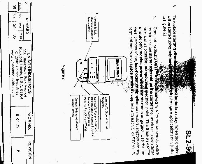

mckervey(at)edge.net
PostPosted: Mon Feb 04, 2008 7:13 pm    Post subject: Slick Mags Reply with quote
Bill,
The new Slick-Start doesn't have a pin 2.
Joe
billderou(at)yahoo.com
PostPosted: Mon Feb 04, 2008 9:26 pm    Post subject: Slick Mags Reply with quote
Joe-
I can't think of a design reason to drop pin 2 functionality except to limit their liability in lawsuits. I suppose that every kick-back lawsuit will automatically name Unison as a defendant and they can create uncertainity by blaming the right mag.
I looked for information on the new version with no joy.
Does anyone have a description of the changes between new/old?
Is the new version now being shipped?
Can anyone send a new wiring diagram?
Bill
mckervey <mckervey(at)edge.net> wrote:
[quote] Bill,
Joe
PostPosted: Tue Feb 05, 2008 8:55 am    Post subject: Slick Mags Reply with quote
[img]cid:002f01c86817$0d4596a0$27ae9804(at)josepheg3rzhs5[/img]
 Filesize:  124.12 KB
 Viewed:  476 Time(s)
