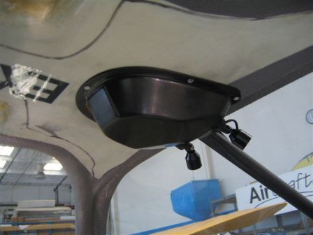

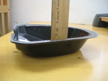

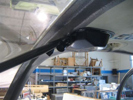

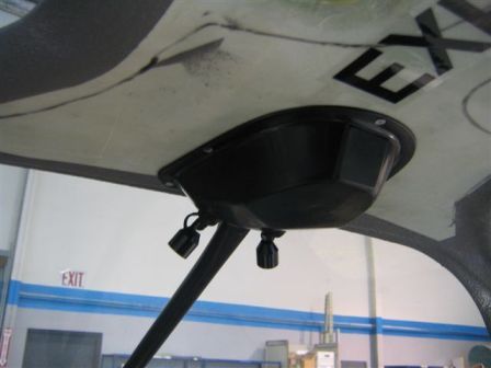

We are producing a small fiberglass overhead console especially for the 10. We made the mold from the top of my plane after the strut was in place, so it fits very nicely around the top of the bar.
I wanted something fairly compact to maintain as much headroom as possible. It weighs 2.4 ounces and is 1 1/2 inches deep. I attached mine with flathead sheet metal screws directly into the ceiling.
I have two of Stein's LEDs in mine. I ran the wires up the strut. There's plenty of room for another dome light and a couple switches, and it's deep enough to put a 90 degree coax connector inside if you want a GPS antenna on top.
It also fits nicely on the baggage area ceiling, although I haven't worked out an attachment method. The honeycomb core wouldn't take a screw too well so a little beefing up would be in order.
I've been meaning to get these and a few other products on the web site but your post seemed like a good time to jump in.
Here are a few pictures. I have several in stock. $150 each plus shipping. Any questions please call.

Dave Saylor wrote:
Hi Chris,
GPS antenna on top.
Dave Saylor
AirCrafters LLC
140 Aviation Way
Watsonville, CA
831-722-9141
831-750-0284 CL
www.AirCraftersLLC.com

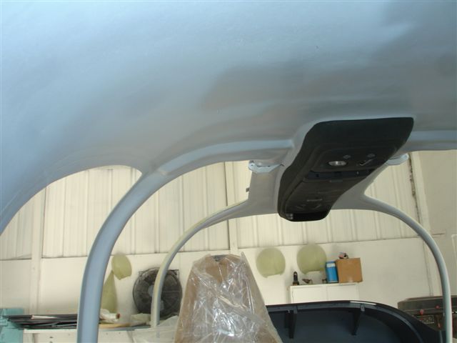

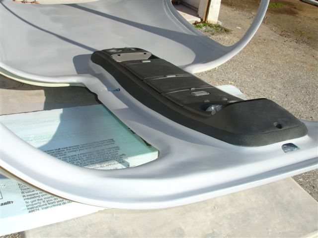

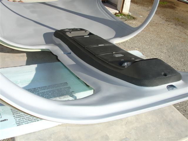

Here's what I did.....
S-10 Overhead Console from Ebay. $50.
Zack

PostPosted: Wed Feb 06, 2008 3:53 pm    Post subject: overhead console Reply with quote
Great, now I am one of the guys that said, "here's what I did" from Tim's forum joke he sent around a few months ago.
But, here is what I did. Did it for less than $20. (not including Steins LED's)
The red lights dim and I hooked the white LED's up to my "Switches" dimmer to I could dim them as well.
So far, it has worked great. I am going to add two more red LED's from Stein that point down on my lap. or to the corners of the panel if I wanted.
[url=http://www.vansairforce.com/community/showthread.php?t 787]http://www.vansairforce.com/community/showthread.php?t 787[/url]

Zack and/or other S-10 console users, do you know the weight of the console? -Andy
Andy Turner
zackrv8
Joined: 14 Jan 2006
Posts: 133
PostPosted: Wed Feb 06, 2008 6:54 pm    Post subject: Re: overhead console Reply with quote
Andy,
I don't know the weight. However, you can "gut" alot of the unneeded stuff out, thus reducing the weight.
Zack
