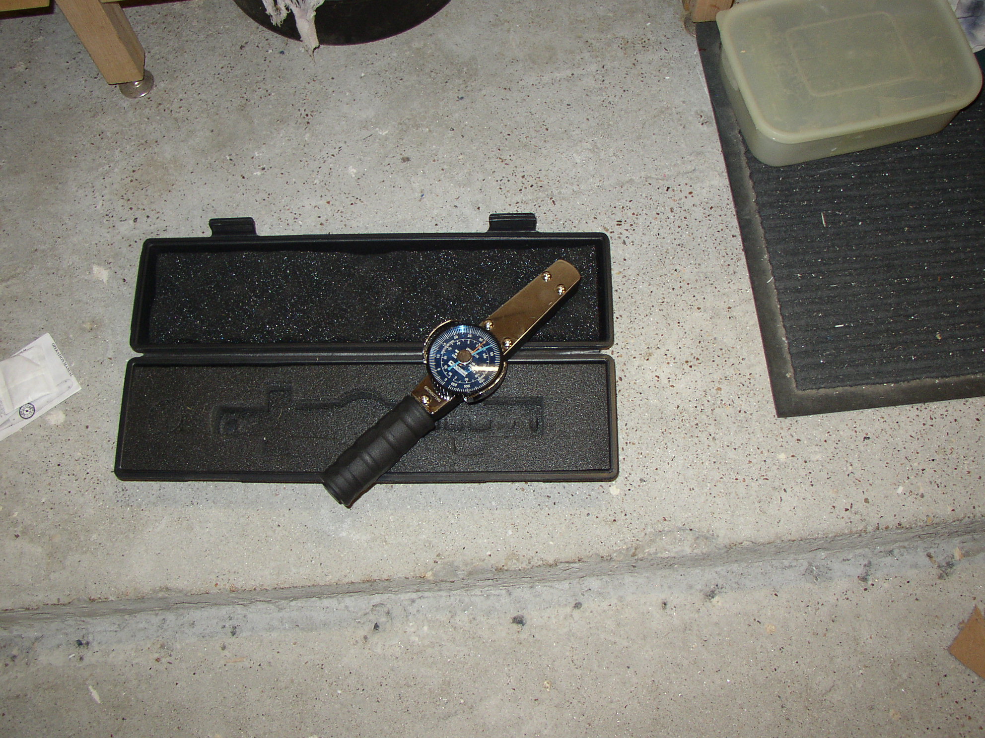

Brad,
Getting back to the original subject, page 7-301 of AC 43.13-1B shows proper torque values. Yes, they are based on shank size, not wrench size. I have this page posted on my workbench as I seem to refer to it almost every day.
As opposed to a torque wrench you'd find at Home Depot, I strongly recommend taking the plunge and buying a quality torque wrench. I have one from US Tool - model TP349 and it's great. If you're planning on installing a Rotax, You'll definitely use the metric (Newton-meter) side for your engine work. I know it's expensive, but IMHO it is a must-have. Here is their website:
http://www.ustool.com/
That's my two cents.

PostPosted: Wed Feb 20, 2008 7:12 pm    Post subject: Torque values Reply with quote
don't forget that you need a calibration check at least once a year. Before the flames start to bloom, a simple fixture with a crank arm in a bearing and a tared bucket with water in it (pure water is 1 gram/cc; 453.6 grams/pound) is a good functional check.
