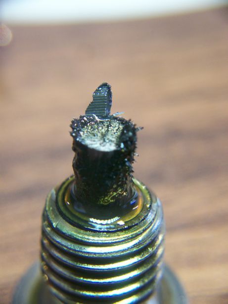

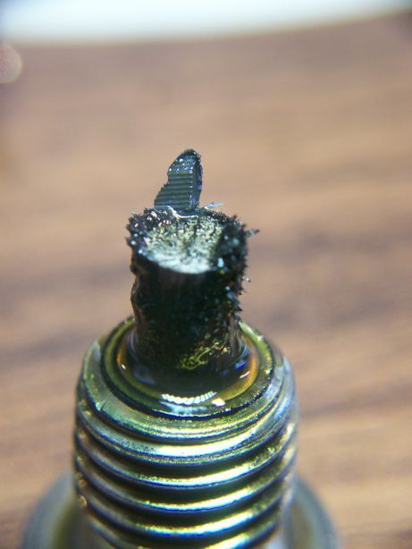

PostPosted: Fri Mar 07, 2008 1:53 pm    Post subject: Re: 912 with low RPM Reply with quote
Be kind to your engine or else.
- The Matronics RotaxEngines-List Email Forum -
http://www.matronics.com/Navigator?RotaxEngines-List
Magnetic oil plug from a 912ULS.
