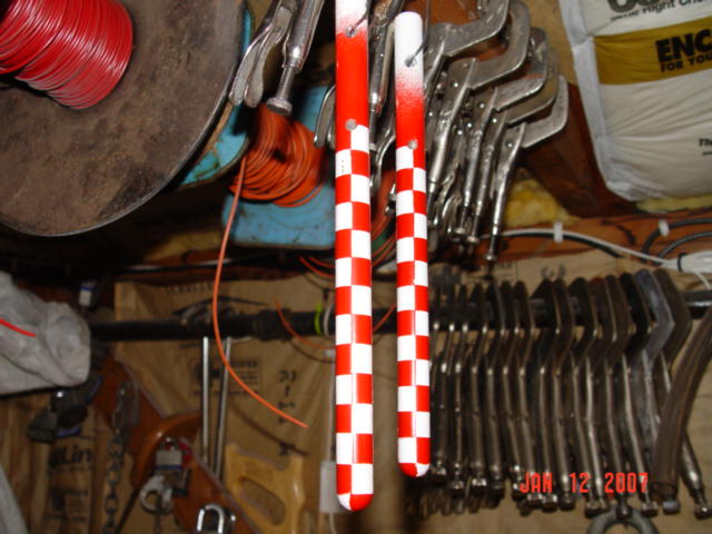

planecrazzzy Guest
Posted: Sat Mar 22, 2008 10:12 am Post subject: Re: Aileron counterweights |
I balanced mine without being connected to the plane....
But later , I extended them about an inch and a half more....
Because when I'd be folding up....The aileron would "hang"
Maybe because of the "angle of the wing" compared to when I balanced
them the first time , the wing was flat...( Level )
ALSO, I adjusted the counter weight "AFTER" fabric and paint.....
Put the "tube" on now....But the balance rod LATER...
Gotta Fly...
Mike & "Jaz" in MN
Snowed in.....Workin on my Buttercup...

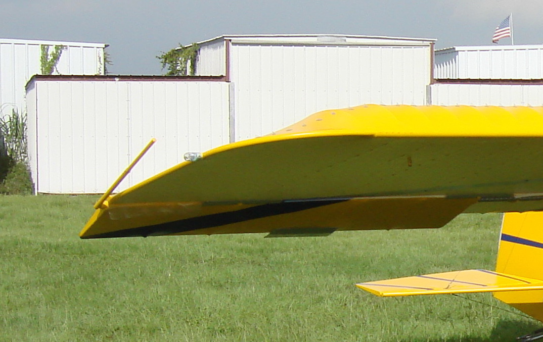

JetPilot
Joined: 10 Jan 2006 Posts: 1246
Posted: Sat Mar 22, 2008 1:38 pm Post subject: Re: Aileron counterweights |
Mike,
Here is a good article on how to balance control surfaces.
http://www.fly-imaa.org/imaa/hfarticles/howto/v6-1-36.html
Also attached are some pictures of the aileron counter balances on my plane, as well as a MK III classic. If you need more detailed pictures of how they are attached into the aileron tubes, let me know and I will take some. After reading some reports of minor flutter in the Rudder of some Kolbs, I also counter balanced the rudder in much the same way as ailerons.
