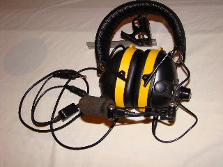

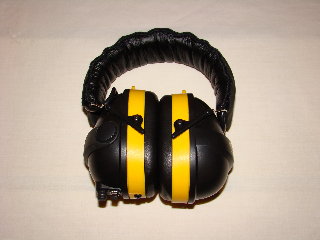

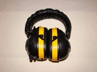

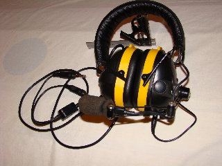

I had planned to have an ANR headset for this summer but hated to pay the price. I had decided to do the upgrade, that some have discussed recently, to my passive headset. While looking for some hearing protection for a problem area at work I ran across a set of ANR ear muffs for use in industrial environments and they even had a 3.5mm audio input jack. Wow only needs a mic. Specs. are 26db NRR passive and 20 db NRR active in the 100 to 200 hz range. The ANR range is 20 to 1000 but is rated at 20 db from 100 to 200 hz.

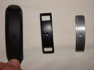

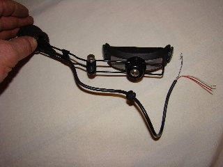

The UPS truck dropped off a package today and I went to work. I mounted the mic from an old headset to the battery cover which required drilling one hole. I also made a piece from 0.050 aluminum to stiffen the location where I was mounting the mic. Everything works well but I have not tested it in flight yet. I will give a report after some in-flight testing, maybe this weekend.
Did I mention they were $149. I have attached a link to the website. I bought them from an online store called Active Forever, They had them in stock.
Hope to fly this weekend.

Got a chance to fly for about 45 minutes today with the adapted ANR headset. It does a very good job. I am satisfied for now. The longivity test begins now. How long will it last????
I had only used an ANR headset for about 30 minutes about a year ago so I cannot compare it to any other sets.
