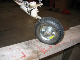

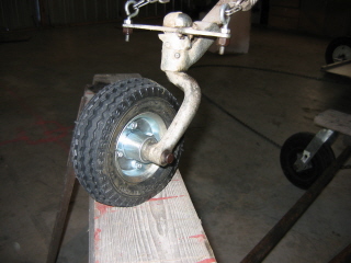

thesupe(at)hotmail.com Guest
Posted: Tue Mar 11, 2008 6:23 am Post subject: Sprung Tailwheel |
I'm just wondering if those that have had the tailwheel spring break were all running the solid rubber Maule tailwheel. I had that wheel on my Avid MK IV, and you can sure feel every little bump through the fusaloge. I would guess that those sharp jolts fatigue the spring. Last summer I replaced the wheel with a cheep 6' pneumatic castor wheel and it was much smoother, the tire really soaks up lots of the sharp jolts. I got some better sealed bearings and put them in the wheel. It would have been nice if Maule made a replacement 6' pneumatic tire but they don't. This worked for me. Jim Chuk Avids Mn

patreilly43(at)hotmail.co Guest
Posted: Tue Mar 11, 2008 7:03 am Post subject: Sprung Tailwheel |
Thanks for the suggestion on the pneumatic replacement tail wheel. I was looking at my solid one thinking it was a piece of junk for the reasons you state and it is heavy. I will find a pneumatic one to replace it.

I had already changed over from the solid Maule tailwheel to the 6"
"Homebuilders Special Tailwheel" as Spruce calls them. It is a much
softer tire than the Maule, weighs less, and has less contact area
with the ground than the Maule. The bearings that come with the
Spruce wheel are terrible though.
By the way, I like the looks of your pneumatic job, Jim.
Lynn Matteson
Grass Lake, Michigan
flying w/475+ hrs
On Mar 11, 2008, at 10:20 AM, Jim_and_Lucy Chuk wrote:
| Quote: | I'm just wondering if those that have had the tailwheel spring
really
> > worked for me. Jim======

_________________ Lynn
