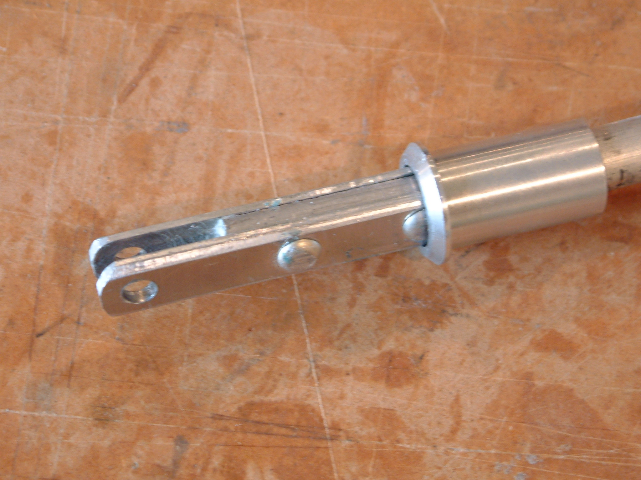

grahamsingleton(at)btinte
PostPosted: Thu Mar 27, 2008 4:18 pm    Post subject: Door shoot bolt pushrod fabrication Reply with quote
Cleve
attached is a pik of Paul McAllister's door push rod. We did those by
hand one Wisconsin winter
Graham
