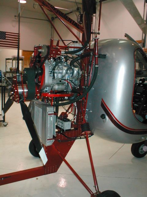

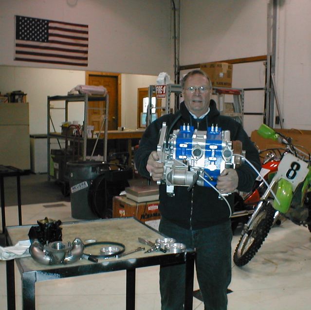

Here are a couple of photos I took when I visited RotaMax. These are
both of the two rotor version which is around 130lbs and 130 hp. They
also have a single rotor which is much lighter, of course. I don't
know if the Gyro has flown or not. I think this will be a very big
deal for the Zenith community especially if they can have a price
point somewhat below Rotax. BTW, this is not new technology but is
based on the OMC racing outboards. Jerry
