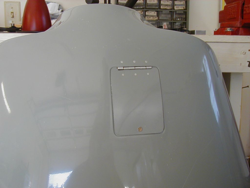

The 601XL cowl that Jabiru USA provides with their 3300 FWF kit comes with a door and a recessed molded cut-out. See the attached picture.
Here is an offset hinge (for an RV-10):
http://www.justrvparts.com/Oil%20Door%20Hidden%20Hinge.htm
If you want a classy latch (instead of a quarter turn fastener) consider a Hartwell fastener. But you have to match them to the depth of the door and frame):
http://www.wicksaircraft.com/catalog/product_detail.php/pid=5075~subid=1456/index.html
-- Craig

PostPosted: Sun Apr 20, 2008 5:48 am    Post subject: Oil door, 601xl w/jab3300 designs?? Reply with quote
I don't know about Jab and Rotax installations, but with a Corviar and WW's cowling package, the oil door would not be in the fiberglass nose bowl. It needs to be in the aluminum part of the cowling. The inboard edge of the door should be about where the hinge between the upper center part and the upper side part is. I think that one side of that hinge could be cut and then used for the oil door. I haven't figured out exactly where the three other edges should be, but I think it is do-able. Since the upper side part of the cowling is so easy to open anyway, I'm not sure why an oil door is really necessary.

PostPosted: Sun Apr 20, 2008 1:18 pm    Post subject: Re: Oil door, 601xl w/jab3300 designs?? Reply with quote
Hi,
This is how I did my installation in the Jab 3300 cowl, mine was the Australian version of the cowl, so it had no pre-molded cutout.
http://www.mykitlog.com/users/display_log.php?user=eddieseve&project=343&category=2447&log=32315&row=11
Paste the whole link into your browser for Photo's
