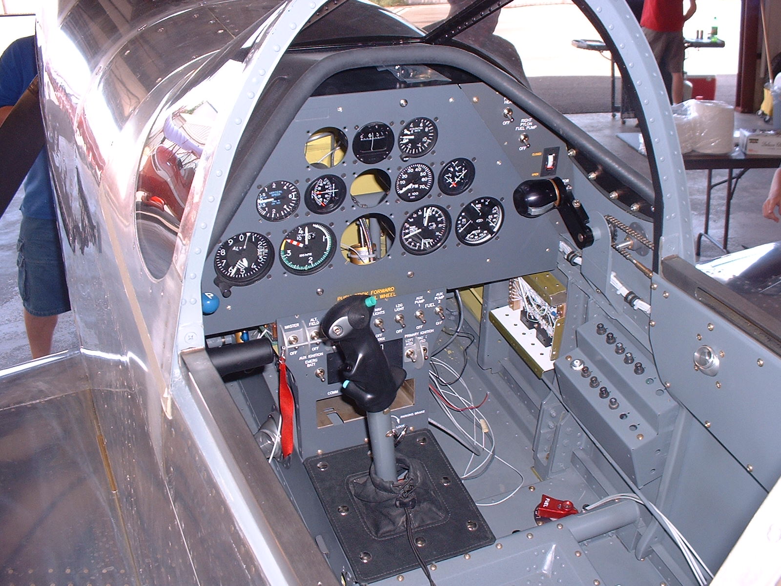

I hope that the file isn’t too large. This is a picture of one of the Stewart mustangs and if you look just in front of the wind screen you can see the access panel. I think if there are no structural problems, I would like too have access to the back of my panel like that. I also, hate to work under a panel, when there could be a better way to do it.
