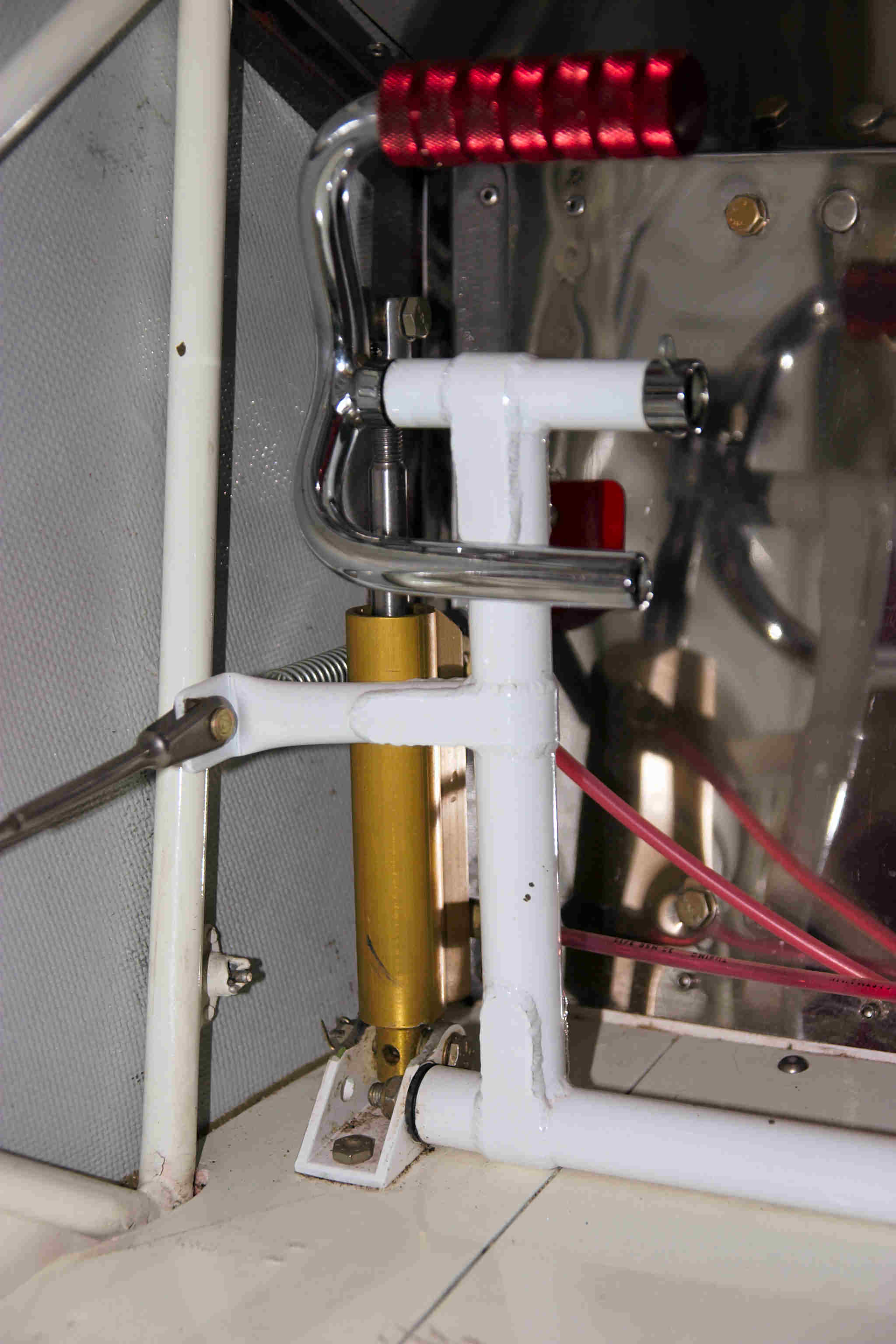

Now you'll notice that neither says what to do. Various
reinforcements have been used. Mine consists of tube width straps
wrapped around a tube then along it's perpendicular mate about two
diameters. This strap is welded all around. I'll send pictures tomorrow.

PostPosted: Fri Apr 25, 2008 7:40 am    Post subject: Model 2 rudder pedal SB Reply with quote
At 08:17 AM 4/24/2008, you wrote:
Do I need to reinforce my rudder pedals, and if so, how do I get a
copy of the procedure?
Jeff,
Attached please find a picture of my rudder pedals.
Guy Buchanan
San Diego, CA

Michel
Posts: 966
Location: Norway
PostPosted: Fri Apr 25, 2008 10:48 am    Post subject: Model 2 rudder pedal SB Reply with quote
From: Guy Buchanan [bnn(at)nethere.com]
That's not a pedal, Guy! That's a piece of art!

Guy Buchanan
Joined: 16 Jul 2006
Posts: 1204
Location: Ramona, CA
PostPosted: Fri Apr 25, 2008 2:36 pm    Post subject: Model 2 rudder pedal SB Reply with quote
I'll pass it along to Bob. He'll be pleased. (Re: picture of rudder pedal.)

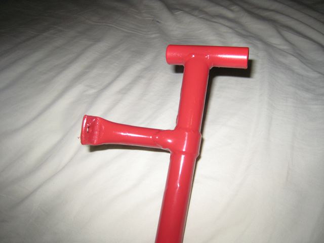

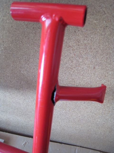

PostPosted: Mon Apr 28, 2008 4:38 am    Post subject: Re: Model 2 rudder pedal SB Reply with quote
Jeff,
The hyperlink is incorrect. You need to remove the ending period from the address so the last digits of the address read "...Letters.htm"
My experience is that the tubes don't fail without notice. They will begin to crack a little and the crack will spread with use. Problem is that the crack on my pedal was on the side facing the firewall so a visual preflight inspection was not sufficient to find the crack. The A&P performing the annual found it.
I suggest that if you continue to fly your Model 1, 2, 3, 4, 5 then you thoroughly feel around each welded joint during preflight and get an inspection mirror to look behind the pedals.
