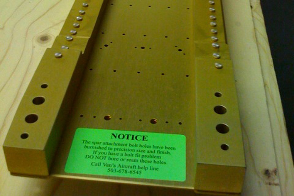

I've had two quality problems with my QBK, both acknowledged by the factory:
- The holes in the upper motor mount brackets did not align with the holes
in the firewall. They were off by 1/8 of an inch. Zenith sent me new,
undrilled motor mount brackets but they were of the new triangular style so
I had to do some rework.
- more seriously all four outer bolt holes in the center spare (two per
side) are 6 to 10 thousandths over. Because the other holes in the center
spar are within spec (and ALL the holes in the wing spare) is seem very
likely that the problem holes were enlarged when the holes in the spar
uprights (6B13-1) were line-drilled. The factory doesn't have a good fix for
this one. Roger quotes CH as saying that 12 thou is within spec but I don't
buy it. The plans called for all these holes to be precision reamed. Note
that because the corresponding holes in the wing spars are NOT oversized I
can't just use a larger bolt even if I could find one.
The only fix I can think of is to remove the center spar from the fuselage,
bolt it to each wing in turn and drill/ream the holes to 3/8ths. I don't
think it is feasible to do this with the center spar in the fuselage. But
another QBK builder is investigating that solution. Luckily I have had a lot
of practice drilling out rivets.
In a few years it will be interesting to look at quality issues (if any)
with Van's RV-12 and Ran's S-19.
BTW: the bottom plate on my front gear tube was square but shifted to one
side by a little under 1/8th of an inch.
-- Craig

I don't think I'd open the holes to 3/8. The spar caps (the 1/4 x 1.5inch bar) is already pretty close to minimum edge distance, even with the 5/16 bolts.
When I drilled my center spar to spar clamped everything together and first went in with a small hole and an alignment bolt, then another alignment bolt, then another small alignment bolt etc... then started opening up each hole and reaming. Took a few hours, but all the reamed holes line up nicely.

Unlike rivets there is no hard and fast edge-distance for a bolt. The
factory has agreed that in principal that the hole can be upsized.
Going from 5/16th to 3/8th is an increase of 1/16th. The edges of the hole
will move half that or 1/32nd which is 31.25 thou. I'm comfortable with
loosing that much metal. Note that I would only have to do this to 4 of the
12 holes.
-- Craig

Zenith told me that it isn't as much the bolt hole tolerance that is critical but the clamping pressure of the bolt that is more important just like the prop. I haven't had any problems with the spars on 3 kits but will check my spars and center section before I install it in the plane. I also fixed the front gear problem by shifting the fork about 1/8 inch it doesn't look all the professional but the wheel pant will cover it.
Jeff
They told me the same thing. But it is at odds with the requirement that the holes be precision reamed. On an RV-7 the equivalent holes are burnished. I’ve attached a close-up of a shot of Lance Gingell’s RV-7a spar. He is making great progress: http://lancegingell.blogspot.com/
BTW: the only way I have found to get an accurate measurement on the hole sizes is to use plug gauges. I bought a set from Grizzly but Zenith has been loaning a handful of gauges near the correct size to other builders to check theirs.
-- Craig

The forces acting on that joint are in shear, not tension. A reamed hole is critical. Period!!!!

Coming from a structures background, this seems completely backward, so I googled a bit and found that for aerospace applications, bolted connections are usually designed with bolts in shear - a no-no for structures.  I'm a curious as to why.  All the web pages I found that might talk about this require a membership.  Could you educate the group a bit on why aerospace connections rely on shear rather than clamping pressure, the norm for most applications?
